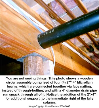

Aside from there not being any room for movement around this pipe, is it really an issue? I thought holes drilled could be up to D/3. In this case its a 14" board so it could be up to a 4.6" hole. It looks a bit close to the bottom edge. But had they actually centered it in the middle third, is it really a defect?
Not sure if this picture and question has been commented on, but in my experience, this Is a defect because the beam has been compromised in a location where Full support is required. I’m sure there are other good engineer solutions to this. also, that Lam must have taken a good drill bit to get through!
