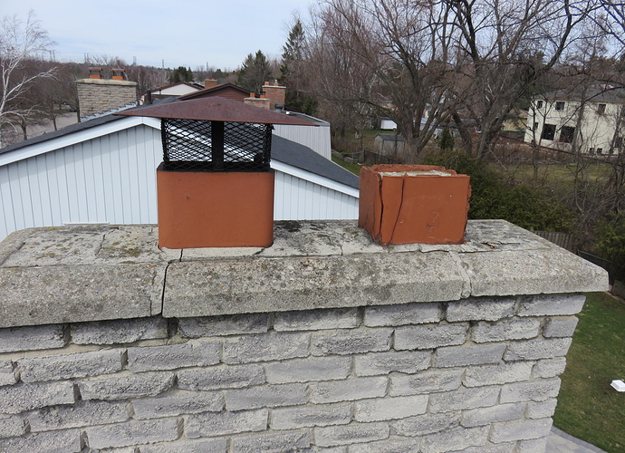

The photo depicted a chimney. The cap cracked and the caulking between chimney liner and cap were missing or deteriorated. Rain water may come into the chimney. It should be replaced. The unused liner were broken and maybe better cut flush with the chimney cap and block it.
