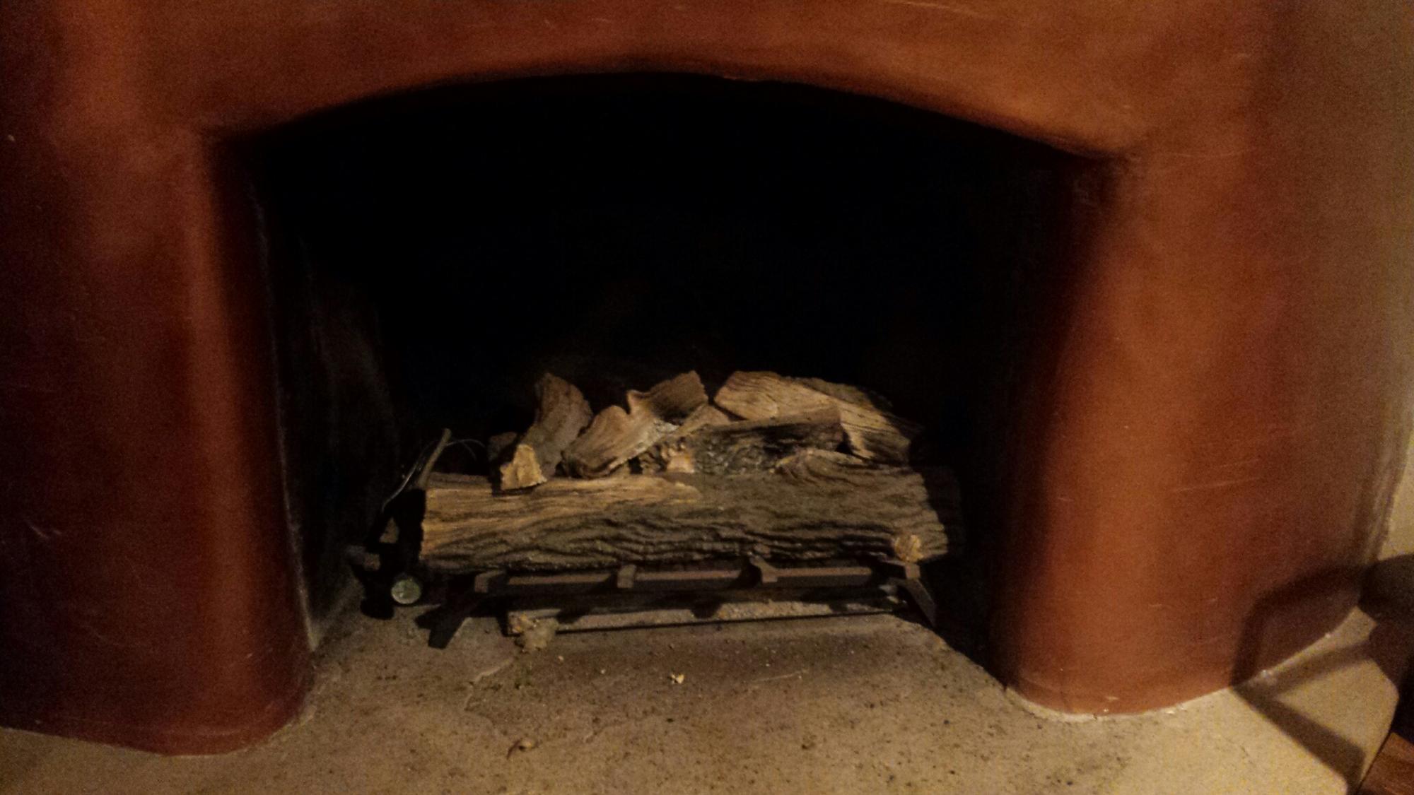

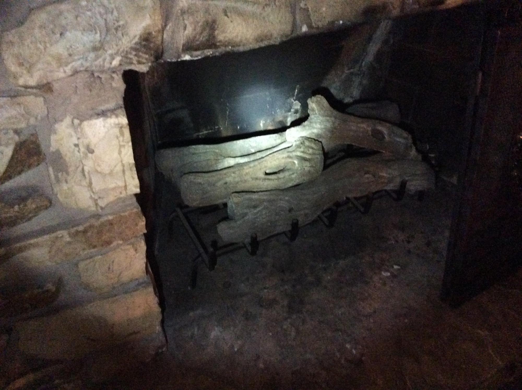

This image is shows a masonry chimney located in the living space of the dwelling. Fuel type is wood / gas log. Lintel shows to be in tact with no visual defects. The damper is in working condition and fully closes and opens at time of inspection. However, signs of creosote are visible and needs to be cleaned by a professional. Note: Before use of chimney and components, ,cleaning and further evaluation by a professional chimney specialist is recommended. Chimneys should be cleaned and evaluated no less than annually.

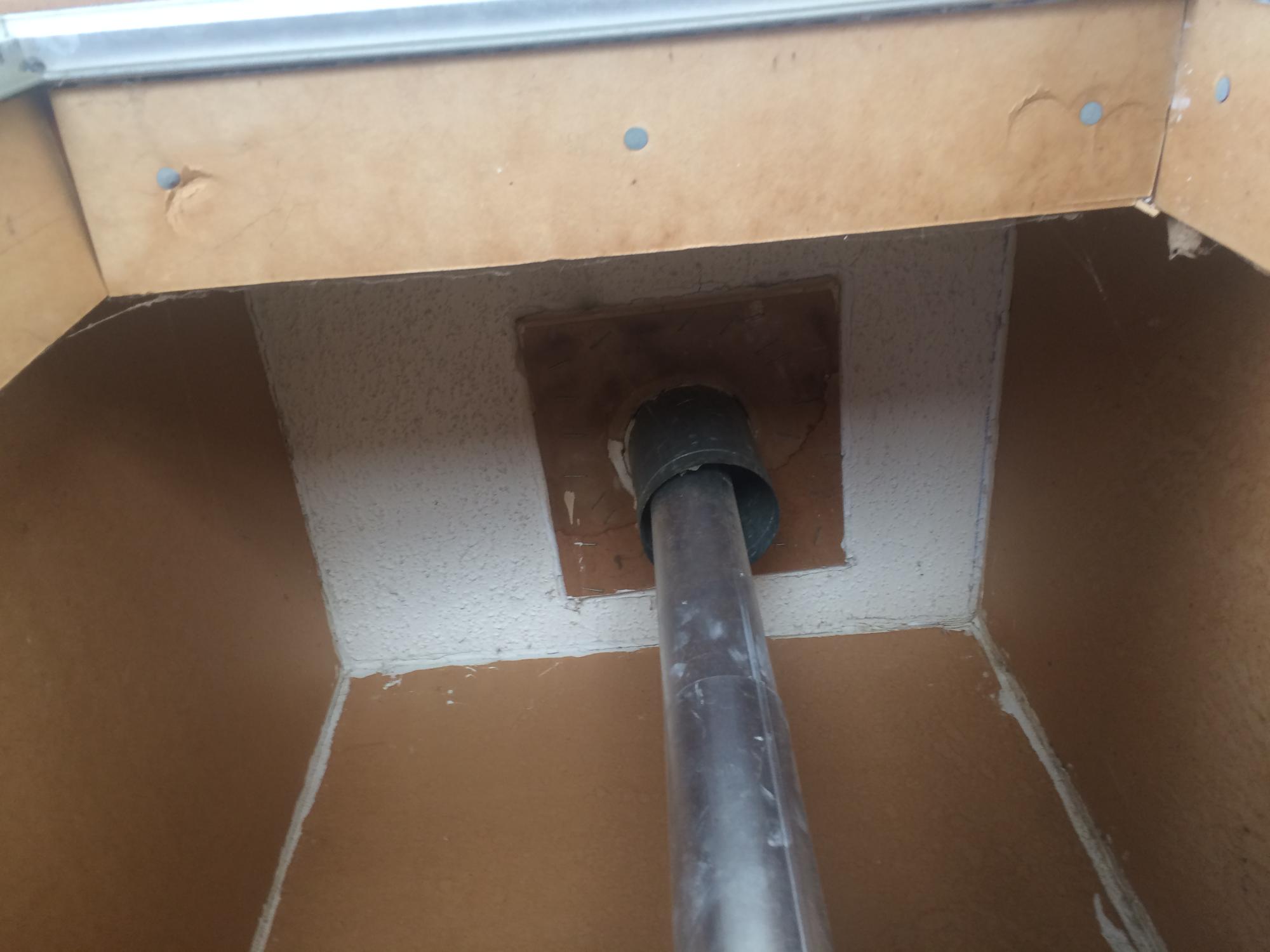

Poorly sealed flue from water heater. Water stains and flue on ceiling.A qualified contractor needs to seal with refractory cement to prevent carbon monoxide into home. Carbon monoxide is a deadly gas. T

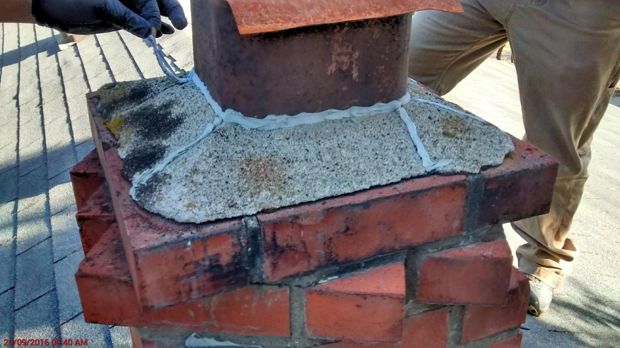

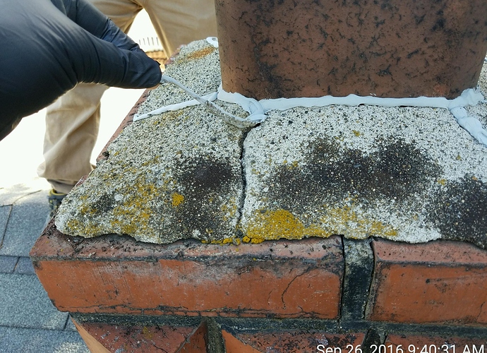

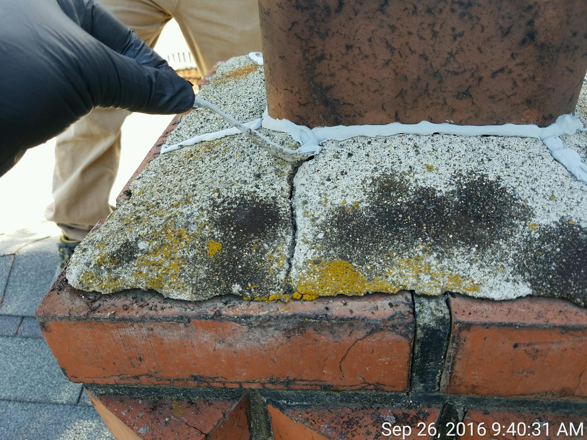

The chimney in this picture has a cracked crown or cap. It has been unprofessionally caulked. It is recommended that a certified mason/chimney professional evaluate and repair.
The chimney of the home had cap cracks filled with silicon. It is recommended that this condition have further evaluation and repair consultation by a qualified/licensed masonry professional.
This picture shows a cracked cap that has been improperly fixed with caulking.
There is also spalling mortor between the bricks
You can also see that there is some minor deterioration of the bricks

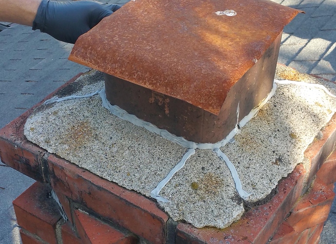

Cracked crown with improper or loose sealant.
This picture shows a cracked crown or cap. also has a unprofessional repair with the caulking.

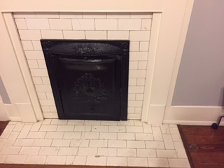

This is an image of a fireplace that is no longer in service and the chimney has been sealed off. However, the hearth meets the minimum requirement of 16 inches. Also, the combustible material is more than six inches above the original fire place opening.

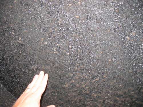

Even though fires places bring added charm, value and functionality to a home in my opinion the risk way outweighs the reward. Out of all the disasters that can plague a home fire is the most dangerous and hardest to repair, if repairable at all. Even with all the added safety precautions in place there is still room for a mishap or equipment failure that can have disastrous results. That being said as a home inspector, even after performing an inspection and not finding any defects I would without a doubt recommend a thorough inspection and cleaning by a specialist in the field. Since it is not in our SOP to perform an exhaustive inspection of a fireplace and chimney, I really feel that this component of a home need to have one done before use and subsequently every year after. Notice the creosote buildup in the picture below, creosote is highly flammable and deferred maintenance in your fireplace can have devastating effects.creosote.jpg
