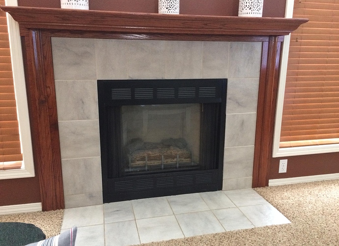

This picture is of the fireplace in my home. It is a factory-built (pre-fabricated) fireplace. Nothing looks defective. Some factory-built fireplaces have a zero clearance requirement to combustibles. So the items placed on either side of the fireplace in the photo are o.k.
When burned, many items can be hazardous to health and be a threat to your family. Only appropriate and approved fuel should be be burned in your fireplace or wood-stove. Painted wood, pressure treated wood, plywood, damp wood, rotted wood, and lint are all examples of things that are never safe to burn in your fireplace or wood-stove. Dried wood, tree limbs, and fire logs are examples of things are safe to burn.
