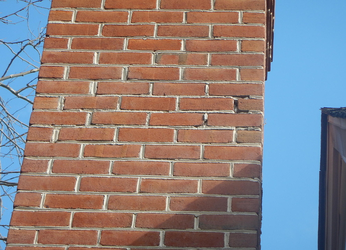

Upon inspection of the chimney there was some mortar joints missing on the top 5-6 rows of bricks. Joints must be filled. If joints are not filled water may seap down behind the bricks and
When inspecting the chimney is very important to look for cracking and damaged mortar joints. These voids can allow moisture to penetrate to the inside of the chimney and flue. This moisture can then cause spalling and damages that are not visible with out a more invasive inspection.
