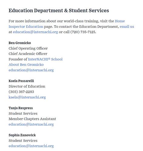

Contact the Education Department directly…
(Scroll down for more…)
