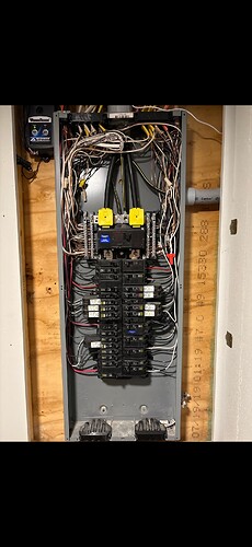

Help me out here. Sub panel is hooked up to a 90 breaker from the main panel . but the panel has a sticker as main principal, and no grounds or neutrals separated. its throwing me off.
I’m writing it up as needs grounds and neutrals separated. plus a few other things.
but is there ever a way to have grounds and neutrals on same bus bar in sub panel ?
here is the main panel
 ![IMG_8859.PNG](https://global.discourse-cdn.com/internachi/original/4X/7/5/f/75ff29e600868c84b16c6d847b536bacedb01282.jpeg)

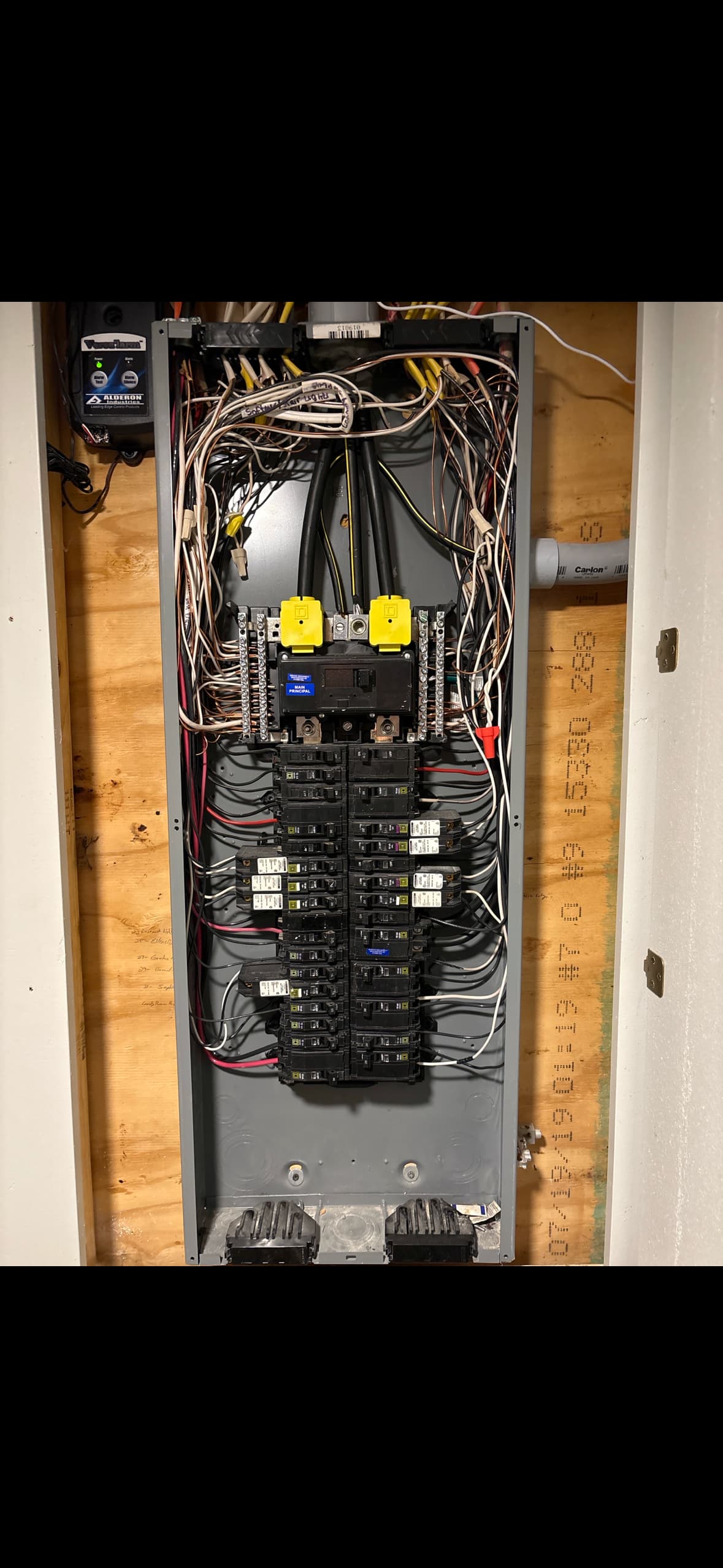

here is the sub panel . grounds and neutrals same bar.
 ![IMG_8858.PNG](https://global.discourse-cdn.com/internachi/original/4X/1/7/d/17d42e465d59b867b5f55cfe3274c00a169998ad.jpeg)

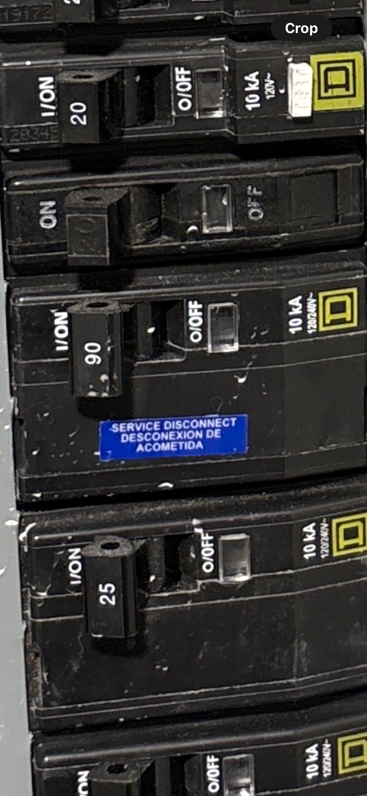

This is in the main panel, 90 amp breaker for the subpanel in the out building.
 ![IMG_8860.PNG](https://global.discourse-cdn.com/internachi/original/4X/5/e/f/5ef04a91f2abc6abec094b12c3cee21753d6c567.jpeg)

> [@pcrooks](#):
The sub-panel must have the neutrals and EGC’s terminated on separate buses. The neutral must not be bonded to the enclosure. The sticker on the 90 amp breaker is incorrect and should be removed because the 90 amp breaker is not a service disconnect.
> [@pcrooks](#):
Only for panels in a separate structure installed before the adoption of the 2008 NEC. Within the same structure never.

Well then depending on what code cycle it was installed under it may have been code compliant with the EGC’s and neutrals on the same bus.

> [@pcrooks](#):
> Was just getting thrown off with the ground and neutrals on the same bus bar.. But it is wrong.
Funny thing is that they wired it correct for a post 2005 NEC installation with a 4-wire feeder and a separate ground bus.

**Author:** ![rmeier2](https://sea2.discourse-cdn.com/internachi/user_avatar/forum.nachi.org/rmeier2/32/59909_2.png) [@rmeier2](https://forum.nachi.org/u/rmeier2)\
**Post date:** [October 1, 2025, 11:16pm UTC](https://forum.nachi.org/t/sub-panel-questions-10-01/261147/14 "2025-10-01T23:16:37Z")
</div>
Yes. The 2005 NEC (and earlier) allowance for a 3-wire feeder was an exception to the general rule of the EGC and neutral being isolated from each other at any point after where the main bonding jumper is installed. In other words the neutral would not be bonded to the enclosure.
