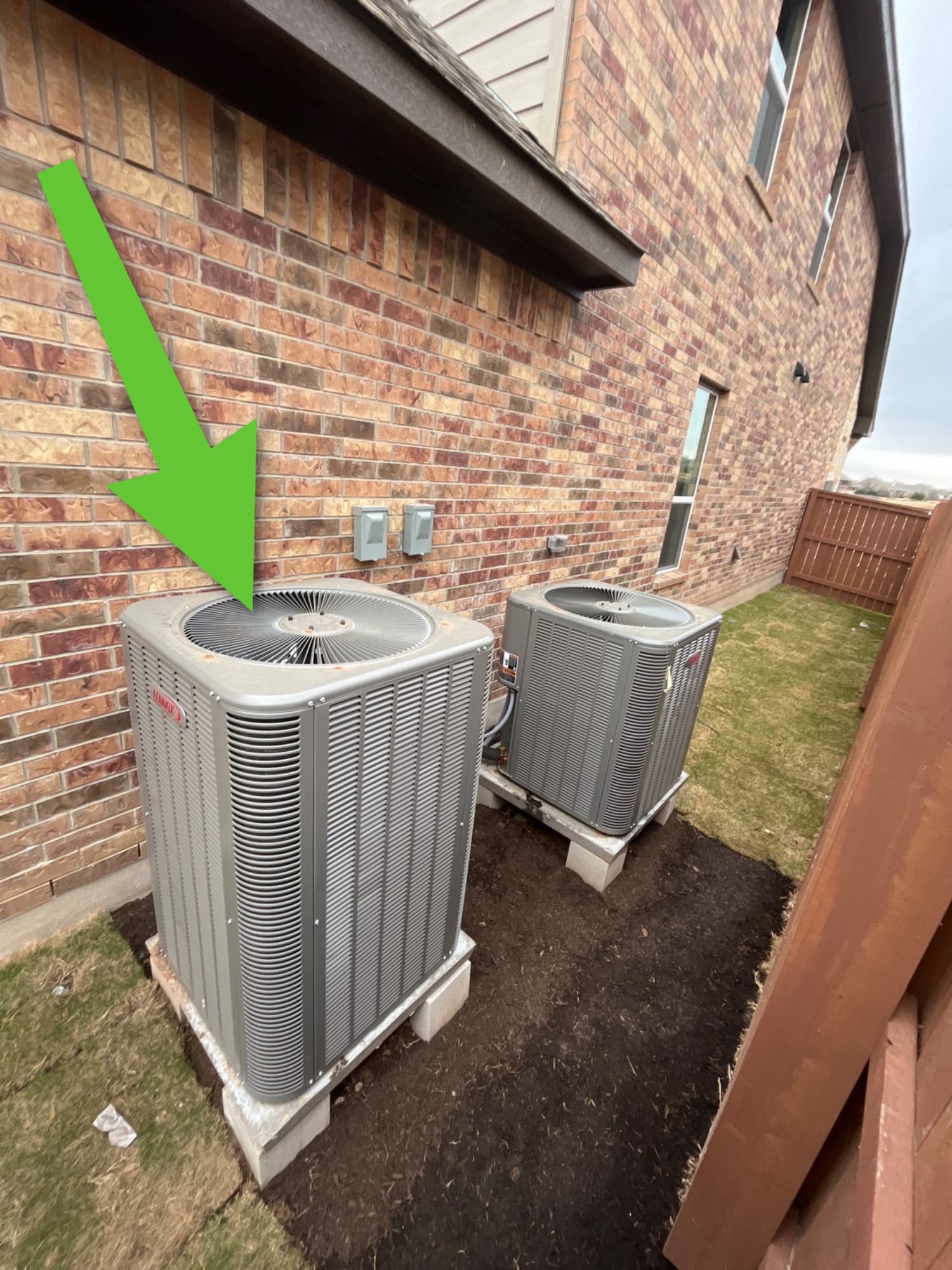

here’s another example. when there are two water heaters (or AC’s, etc etc), i provide an informational item for both and label them #1 & #2, so that i can differentiate them in their respective deficiency comments.
to do that, I need a photo of both of them.
sometimes its hard to get a clear shot of both of them in a tight attic.
edit: and a similar example with 2 ac’s in a tight side-yard

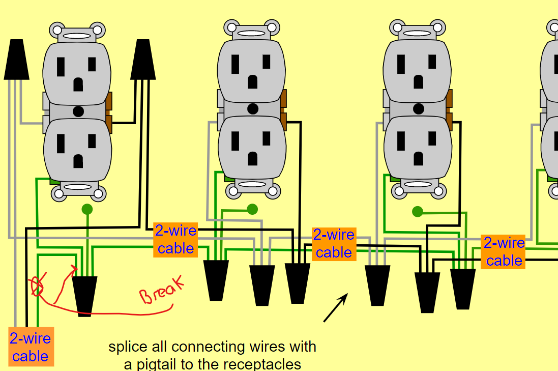

Outlets are wired in parallel not series.
Well, I there is certainly series wiring in older homes or if a DIY person got a hold of it. I was just saying, not all things are as apparent as they seem.
I have a question though. In this parallel wiring, would a break in the ground here show an open ground downstream at all receptacles?
