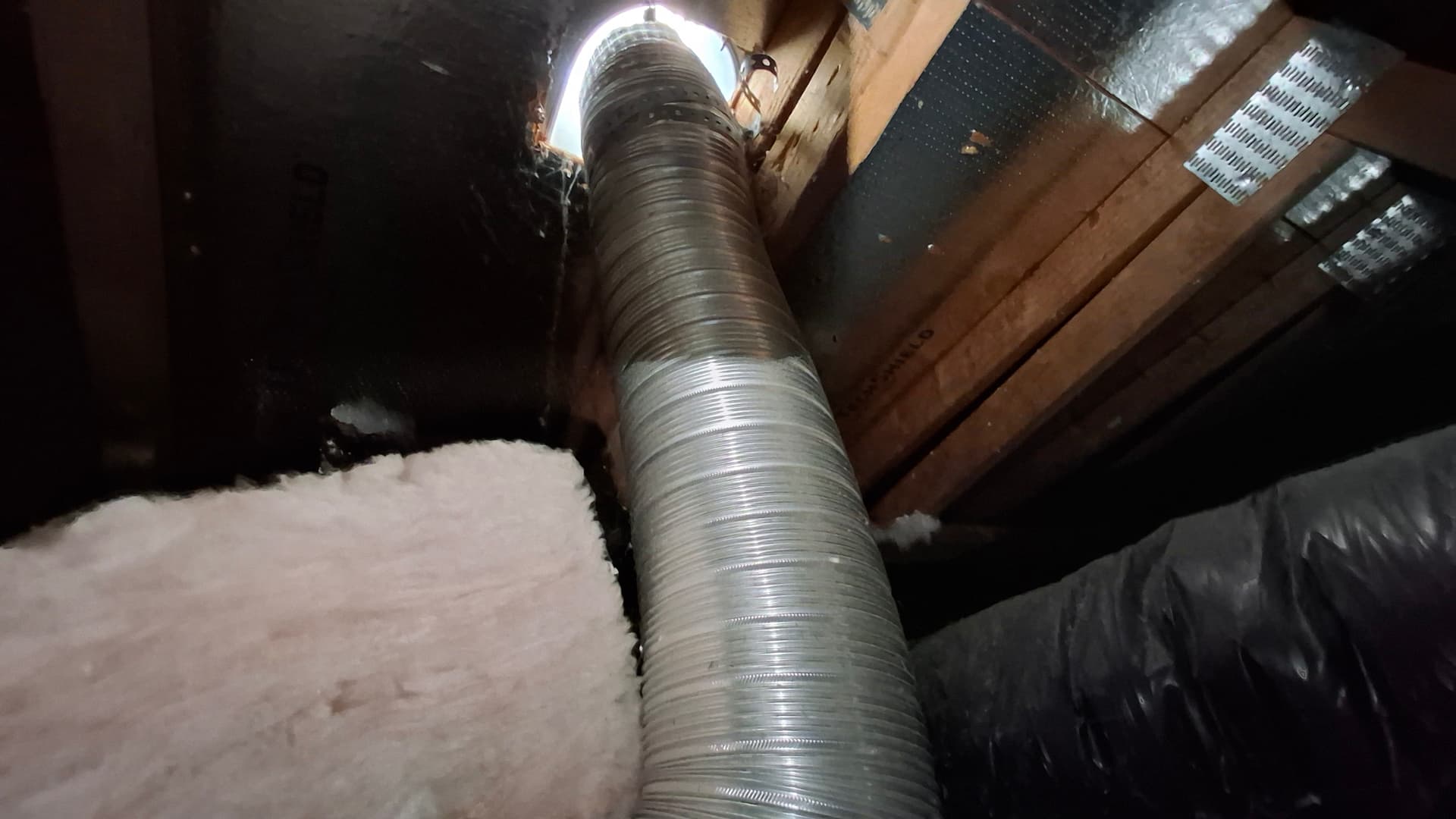

During an inspection of a two-story house, I noticed a suspicious vent pipe in the attic. I’m not certain whether it’s currently in use—it doesn’t appear to extend beyond the exterior roof structure, and there seems to be a large opening at the top. Unfortunately, my drone was out of commission, so I couldn’t check the roof’s exterior.
Based on the condition of the roof insulation (and the fact that it rained recently), it doesn’t look like there’s been any water intrusion. This vent pipe is located above the second-floor laundry area. Can anyone help me figure out what this pipe might be for, and whether this situation should be considered a defect? Thanks!

Try listing the top 3 things you think this might be for…

> [@zhuang2](#):
Where was your 12’ extension ladder? That length will easily reach a roof line at 20 feet. I don’t think anyone can answer your question without a picture from the roof view.

> [@zhuang2](#):
What did it sound like when you started the dryer?

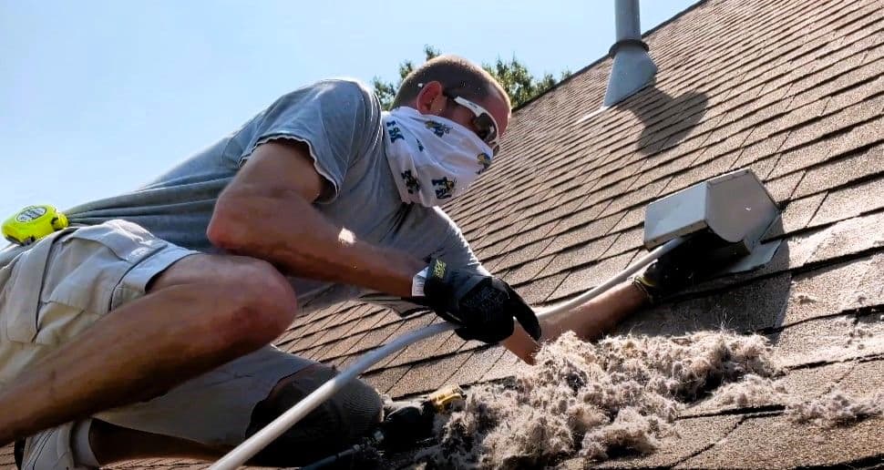

If it is a dryer vent, I never understood why any builder would vent through the roof. I’ve yet to come across one, but will make note of it when I do…

Sometimes, the easiest way is to rule out what it’s NOT for. Could you verify all the bath/laundry fans elsewhere? Dryer vent? Kitchen range exhaust? Gas appliance vents?

Let me get more pictures from roof
Thank you

> [@jspencer](#):
> > [@zhuang2](#):
> [@zhuang2](#):
> Thank you
Did you listen to the pipe while the dryer was running?

> [@zhuang2](#):
Unless you located the dryer vent hood in a different area, I’d have to go with dryer vent duct, and one that looks to be improperly installed.

What was at the other end of the pipe?

> [@zhuang2](#):
> and whether this situation should be considered a defect?..
This looks suspiciously like daylight. If that’s the case, what the pipe is for doesn’t matter as much, lol. At first I thought reflection from the flashing, but I don’t know. Think I see blue sky?

Looks like a bathroom exhaust fan vent to me, and it doesn’t look like it was sealed properly as far as I can tell from the photo.

> [@zhuang2](#):
Question: _What is the insulated vent for to the right of the vertical vent pipe?_
When was this installed? Refer the venders agent for disclosure.
I would have turn on the second floor bathroom fan first, and later the dryer to hear what the vent might me for.
If it is for a clothes dryer. I suspect it is installed in a site manufactured roof base with a whirlybird roof turbine vent, due to the visible daylight surrounding the vent pipe.
As well I suspect it needs to be wrapped in insulation for 24" to reduce the chances for condensation.
