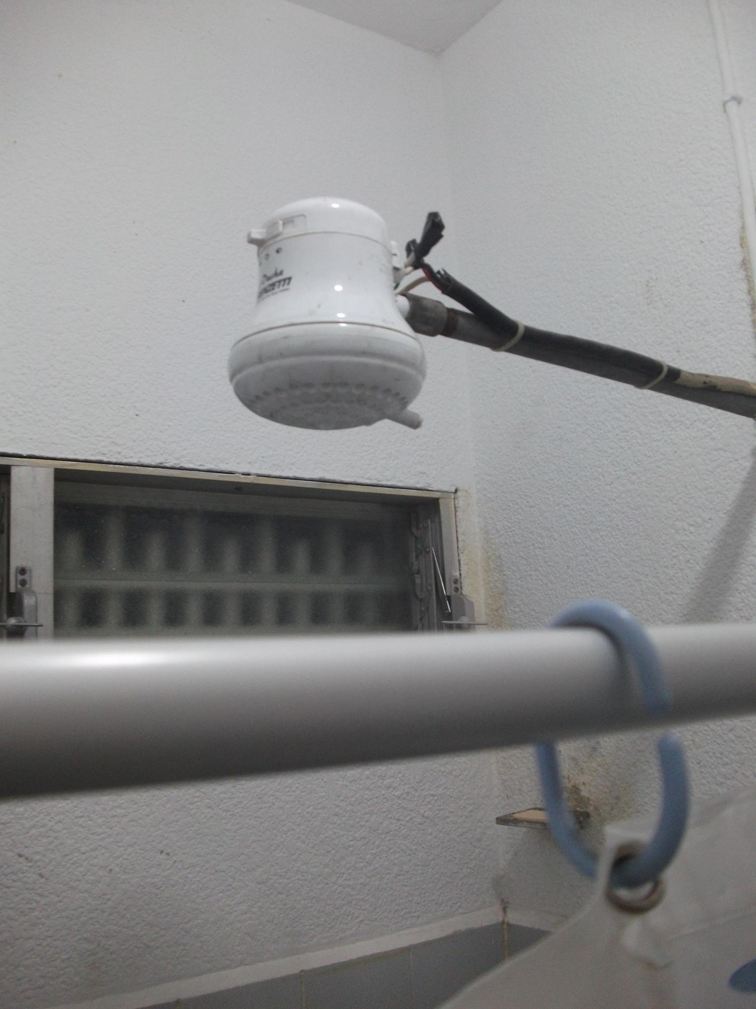

A favorite device thatkept popping up was a high-voltage, electrical water heating showerhead, whichI referred to in my written report as the “hydraulically actuated rain ofdeath.” I came across the 120-volt model quite often, and the much older240-volt models were sometimes found in the older homes.
The difference between thetwo is that the 120-volt model could knock you on your ***, but if the 240-voltmodel malfunctioned it would cook you like a Christmas turkey. The mostcommon problem with these lethal devices is the lack of a properly bondedground connection.
I did an inspection on aplace in town that had been continuously occupied for the last 157 years andthe owner claimed everything worked just fine. In the course of the inspectionI noted the entire upstairs was ancient knob-and-tube wiring with lever styledisconnects, each with a glass fuse, which were being used as light switches.
When I got to the upstairsbathroom I noted the high-voltage showerhead was accompanied by its own leverstyle disconnect switch conveniently located next to the shower control valve.Having 240 volts in a rusty steel box, within easy reach while under theshower, conjured visions of Larry, Moe and Curly in a smoldering heap.
To top it all off, as Iopened the disconnect box I felt a slight tingle of voltage. Each time I touchedit, in fact. I checked it with the electrical meter and found it to behemorrhaging 17 volts between the rusty box and any handy ground,including myself.
Just when I thought it could not get any worse I noticed the two fuse socketswere devoid of fuses, and instead held Mexican coins that dated to the 50s.Moreover, the vile contraption had no ground whatsoever.
When questioned about thecoins, the older woman who was selling the house told me her father put them inmany years ago because the fuses kept blowing, and they were expensive backthen. She went on to explain that no one had used that shower in a long timebecause the shower downstairs had much more water pressure.
Whenever I think back onthis incident, I have to wonder if a life was saved because of a gravity flowwater system.
