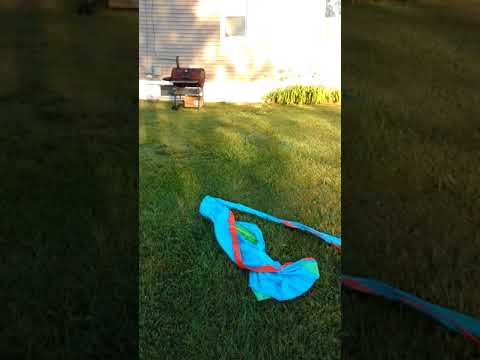

Day before exterior waterproofing job, Q, does the grade slope AWAY from the dumb back basement wall? Duuuuh, yes it does. Then why does the basement leak MarkYYYY ?
As usual, because there were exterior cracks, cracked parging etc in the stupid wall!
Ya see the corners of block wall i point out, huh? Someone previously slapped some mortar on crack that extends above ground level lol, well guess what, THAT… doesn’t do squat for the rest of the cracks that extend DOWN below grade, hellllllllllllllllllllllllllllo!
Was a 2 day job, about 62’ total linear feet, hand dug, back wall is BOWED IN
