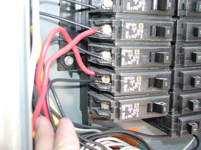

I agree with the original post. I would call it out for two reason. First of all no one can tell from that picture if it meets code. Remember code is the minimum standard. Second of all it is poor workmanship. Who ever installed it that way was lazy.
I called this out two days ago. What do you think? Wrong call?

Those breakers are designed for two conductors. . .
However, the conductors should be the same size.

Absolutely!
> [@gheller](#):
Tell me why. Seriously.
There are some who would call out a splice in the panel. They would be wrong as well.

It is not the internals that allow this. It is the way the termination is designed and tested.
For reference for current breaker styles look on the side of the breakers on the shelves in the stores. You can see the pictogram to see if 2 wires are allowed and the size ranges.

Breakers that are only designed for one wire may only tighten down on one wire allowing the other to possibly arc.

Square D allows double tap, but not two different size conductors. The larger one will be tight, but the smaller will be loose, not to mention the different amp ratings. BTW, this is different from the original post.
