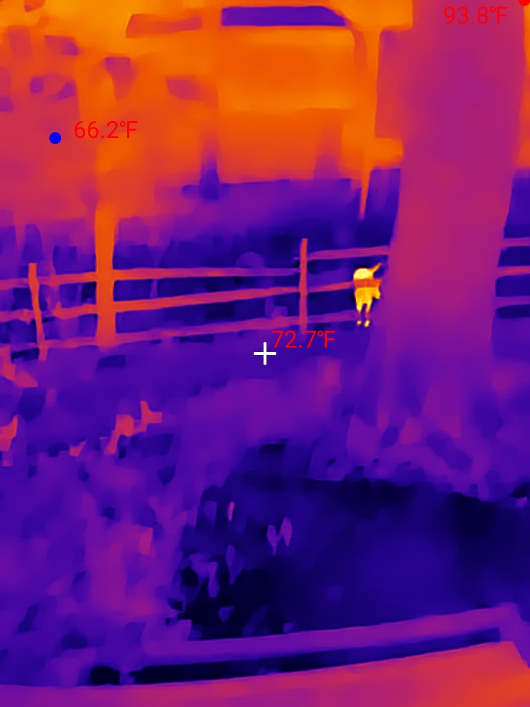

Seems to be able to pick up an animal in complete darkness. It was night time and dark when the neighbor’s dog ran out. I grabbed the camera and there he is. 100% unable to see him with the naked eye. It was black soup.

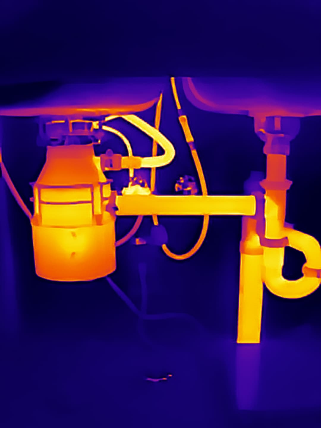

A couple images comparing my pocket 2 to this P2.
Thermal Master:
Pocket 2:
