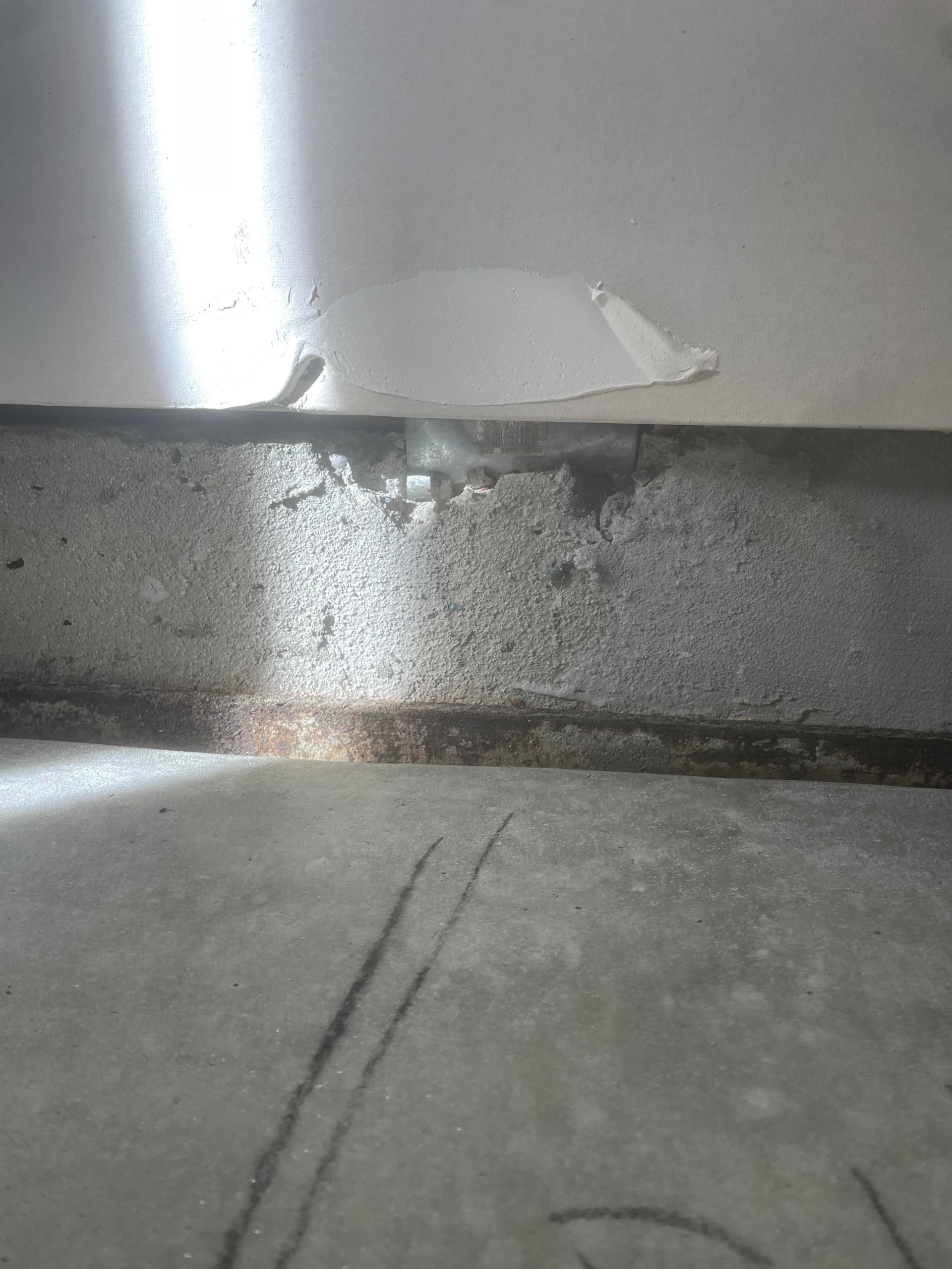

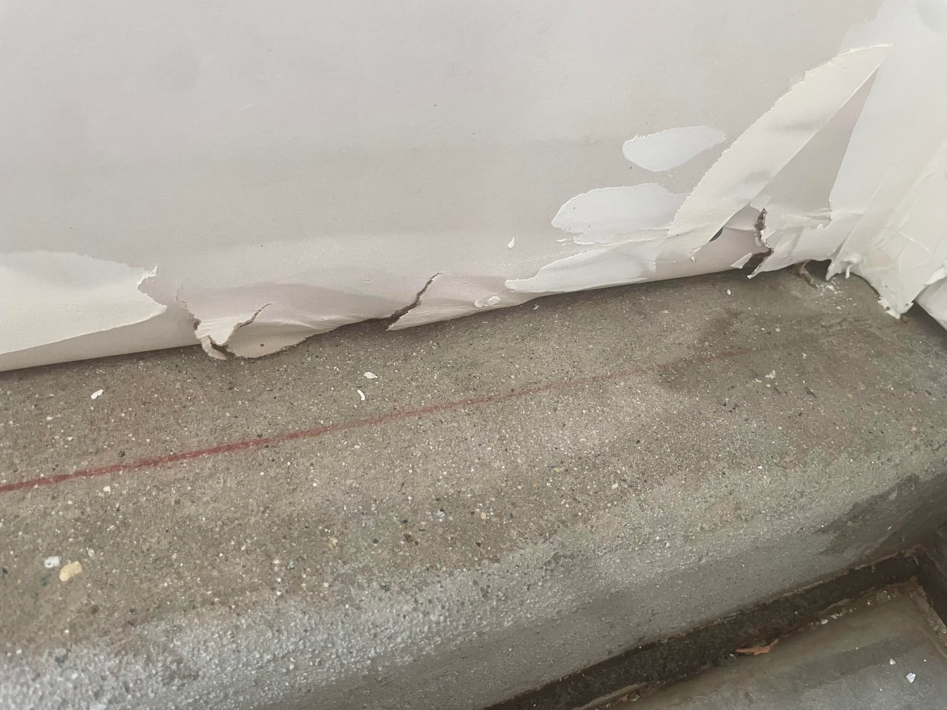

These photos are from a new build construction, this is inside the garage, is this acceptable for a brand new house?
Cosmetic, they can patch the cement and fix the drywall. Hopefully they added an anchor for the failed mud-sill anchor.
Not an issue. IMO
Looks like one of the STHD hold downs.
See below for details.
It’s a garage and it all depends on what they paid for and what was in the specifications.
I wouldn’t worry too much about the straps. Typical install. They usually get bent up quite a bit during construction.
Looks like the drywall was damaged when the installers used a toe lift to get it off the concrete and they didn’t fix it when finishing. Cosmetic issue, easy fix.
