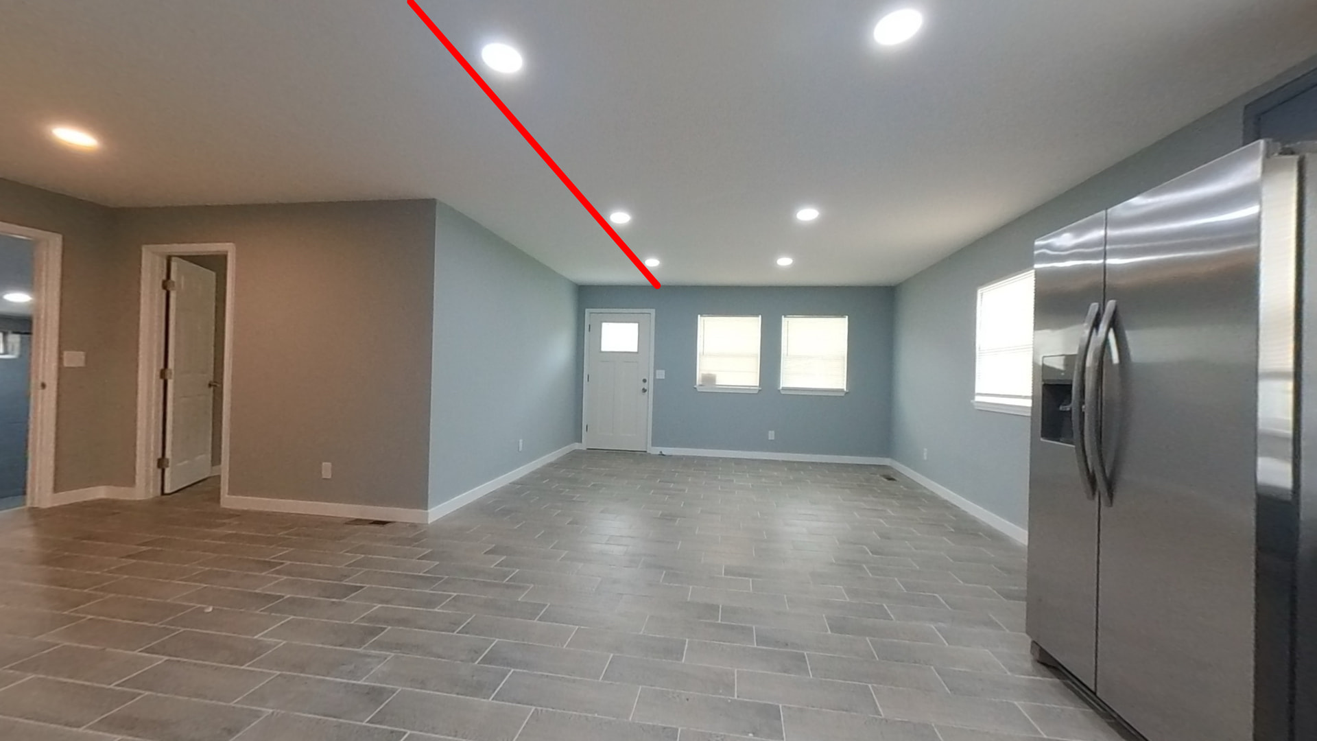

Today’s renovation was a 1,516 sq ft, 3/2 built in 1960. They’ve gone with an open concept but I think they didn’t do it right. My concern is the beam supporting the roof/ceiling was not properly constructed. They constructed a beam by nailing together two 2x10s and ran the span for 29’ 3". The roof was low slope so I couldn’t get into the attic to view the other end of the beam. The photos show the end of the beam near the scuttle hole (in the hall next to the kitchen cabinets), a junction box for reference that shows the load bearing wall and the corner where the kitchen cabinets are located. Other photos show the beam going off into the distance. I had to enhance the photos to take away the shadows in some of the attic photos. Other photos show the position of the beam in relation to the rest of the room (red line on the ceiling). My biggest concern, one of them at least, is where the beam is out in the middle away from two load bearing walls. (the load bearing is an assumption as I had no way to verify it). The report will indicate the questionable installation and request a review by a structural engineer or presentation of the engineering documents from the contractor that did the renovation. Any input would be appreciated.

Hey Larry, I was afraid it would be confusing. As I was on the ladder in the scuttle hole I could look and see that the beam was composed of two 2x10s (4x10) screwed together. The whole length of the composed beam is ~30 ft (29 ft 3 in). As I looked down the length of the beam I could see where one of the 2x10s composing the beam ended and then another 2x10 began. The length of that 2x10 was 10.5 feet. So I know that one portion of this 4x10 beam is made up of a 10.5 ft 2x10. In my mind, 30ft is a long span for a composed beam.
Hey Larry, the red lines in the photos are an attempt to show the location of the beam, not to dictate length. I should have said that when I posted.

It is unlikely that any structural engineer signed off on the design, so recommending that the client ask for the finalized building permit and design documents is the absolute right call.
It would take a large multiply LVL to support a ceiling and roof over the distance suggested. Was this renovation under a building permit? If not, l would state the roof framing was not fully accessible for inspection. If the ceiling or ridge line had visible sag then suggest further evaluation by a structural engineer. Typically a low slope roof your photo indicated would require a ridge beam with intermediate supports at some interior load bearing walls.
