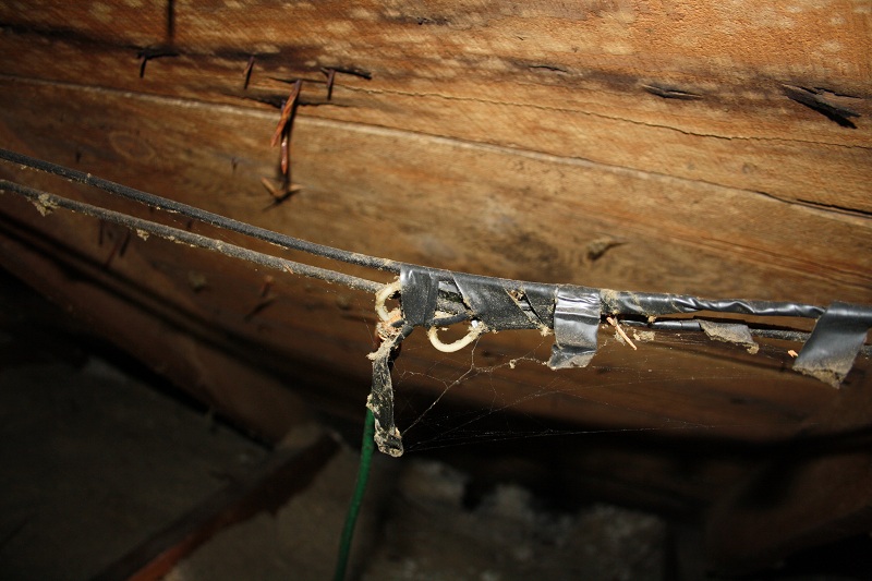

This is why I get paid for inspecting.
Found this in the back section of an attic. The buyers were happy to know if was there prior to signing off on the home. I don’t think they baught it.
was it still energised ?
Yes it was still active. It ran the entire length of the attic. It was spliced in twice as pictured.
ouch…nice find that…
Very typical around here, see weekly.
Had one today.
Glad you noted for your client!!
Typical here on the Main Line, PA.
Why would they choose to not negotiate and purchase?
Wow, you are @#%@## amazing. Are you a CMI???
because if they find another home on the street, neighborhood, …
guess what they would find…
More K&T Wiring…
