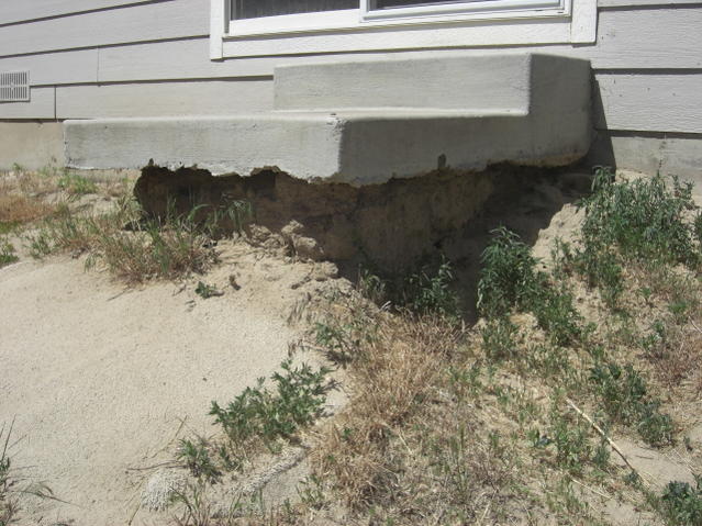

I need some better verbage to describe the problem here.
I believe I’d say something to the effect that:
“the concrete pad/back step needs underlying structural support, before it collapses.
Recommend repair by a concrete contractor”
Rear steps have been undermined where the soil is washed away. We recommend locating and correcting the source of the condition and replace the missing soil…
Chuck
It’s cantilevered… what’s the problem? :mrgreen:
(PS… as Chuck said)!
Thanks Chuck…it sounds better’n what I was thinking
(“I’m surprised the damn thing didn’t fall away already!”)
