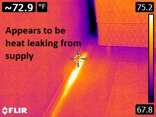

Agree with these comments. Today, the flip was missing a supply register in the master bedroom. IR may have found it covered by the laminate flooring. We had other issues, but this was the one that animated my client.
