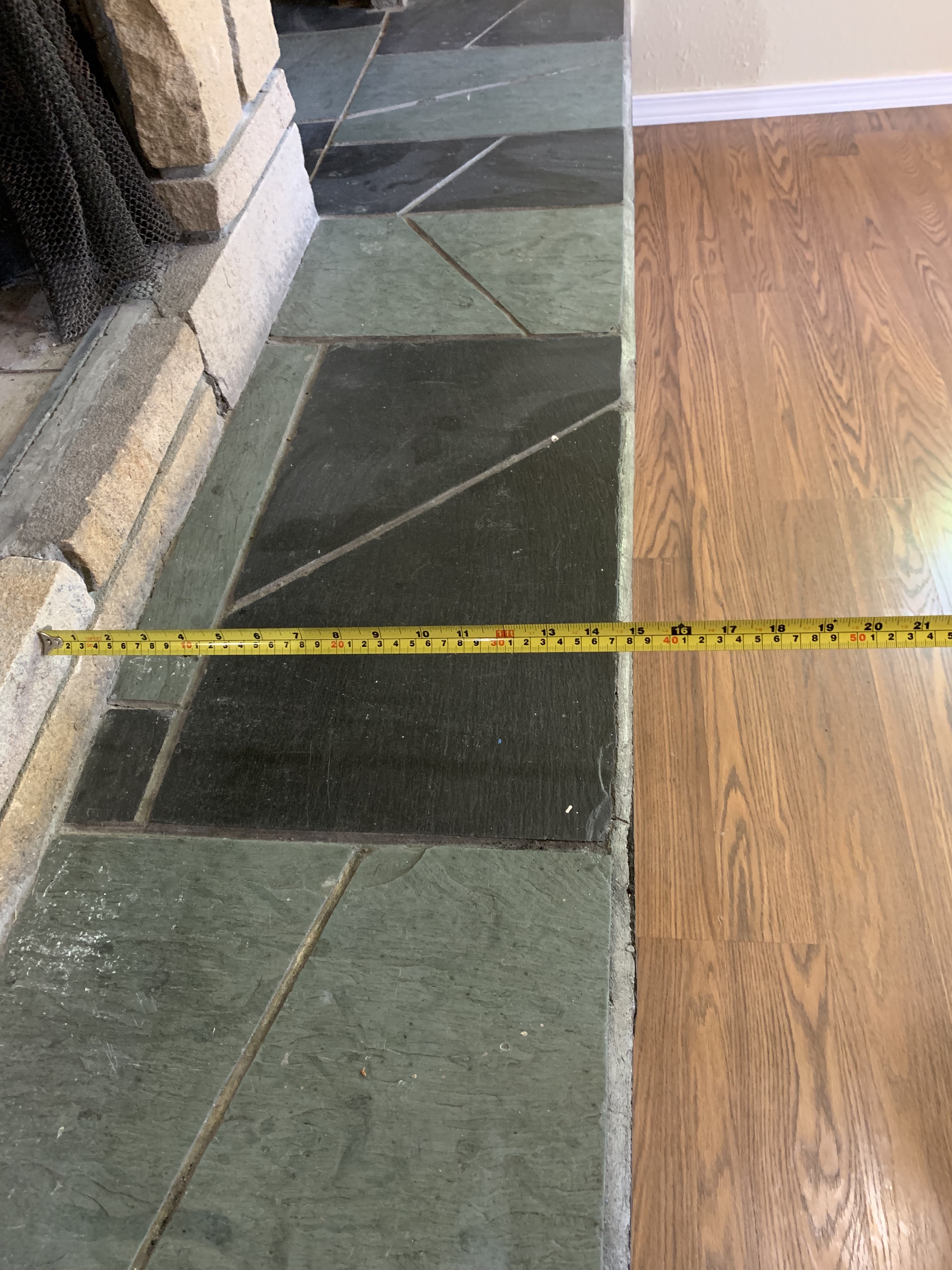

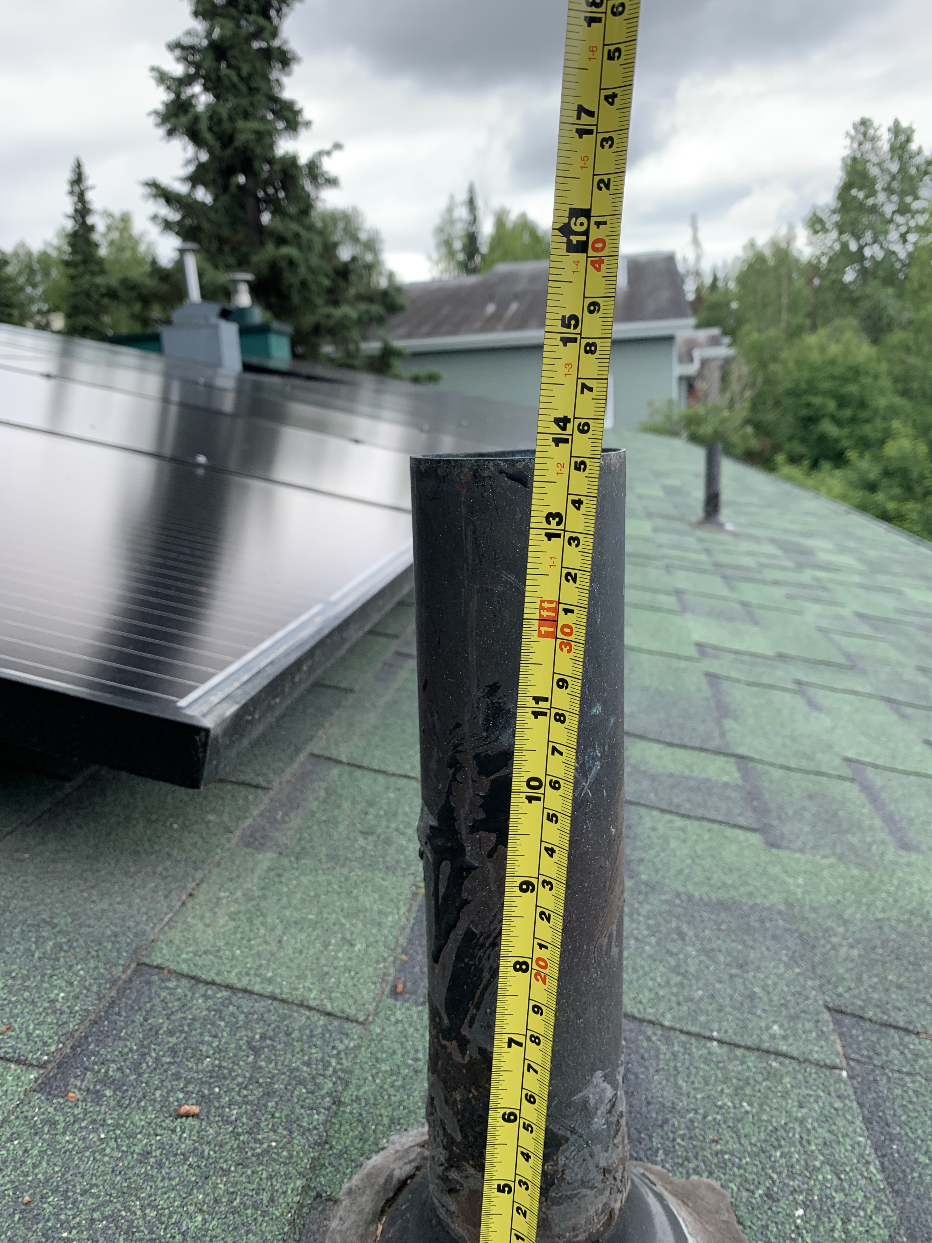

How come you don’t include a photo in the report with your tape?
Here are some examples of my including the tape measure. Attic spaces with insufficient insulation, riser height difference, guardrail too low, plumbing stack too low etc…

Furthermore, I can describe all the defects you just demonstrated with a tape measurer without using a tape measurer or implying I used one.
Example. Hearth extension was too narrow. Per modern building standards hearth should be blah blah…recommend correction.
Vent pipes were too short. Per modern building standards blah blah
