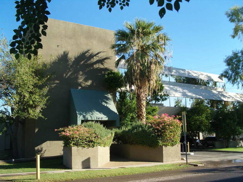

Built in 2001, I have not seen so many blisters in a foam roof in quite some time, open blisters.
Leaking like a sieve (when it rains-:))))

it may be a stupid question but what do You attribute the blistering to Dale ?

Seriously though, until you experience it, our sun is just simply brutal. It is continuous and direct. Combine that with poor or lazy workmanship and hence, blisters.

They last forever if you keep a reflective sealant on the Foam, James.
Like Dylan said, poor workmanship, usually the mix is not set correctly and the foam gets air bubbles, which enlarge with extreme heat from the sun, or the foam is applied over a moist surface, but that is not usually the case here…just piss-poor-work-and-product…!

BTW, I can add another installation problem to Dales’ list, see the last picture, in that one they had applied a new thin cover coat over an existing SPF roof, but hadn’t preped the surface so the new application had no “key” you can see the undercoat still has its’ reflective coat applied which the new covering couldn’t adhere to.

SPF is a good system if properly applied and maintained (which you never see) the gravel is used for UV protection, but is a bad idea in my experience as wind scouring tends to create damage, also if the roof gets too much foot traffic this drives the gravel into the surface. I also see a lot of mechanical damage caused by HVAC contractors dragging new compressors across the roof.
