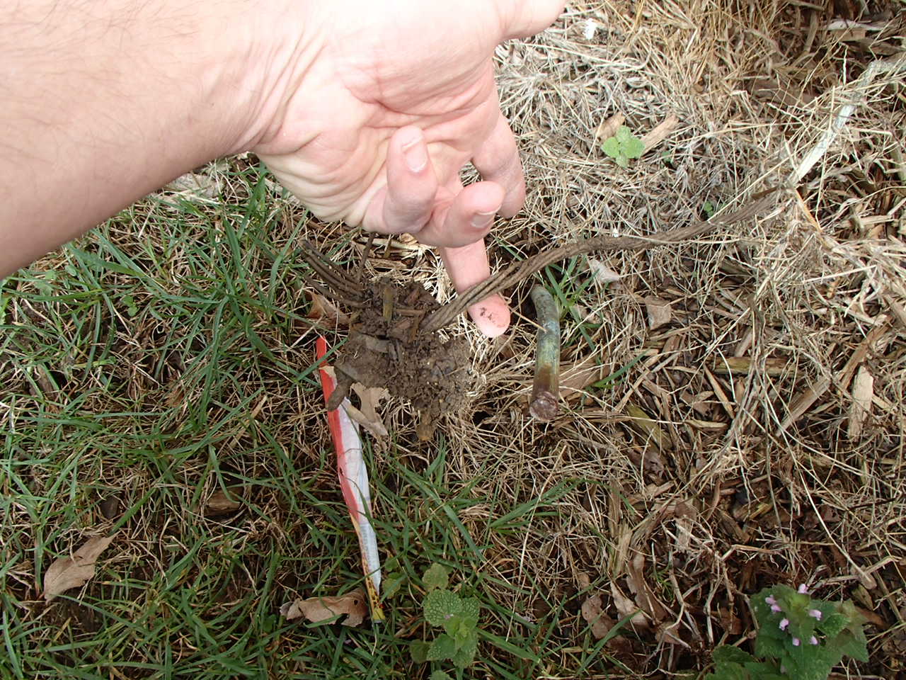

Grounding rod was not connected to the grounding wire. No one had any idea that the problem existed.
Good find. Chances are fairly good that if the rest of the system were installed correctly (particularly the main bonding jumper and another electrode) that missing connection would never be a problem.
