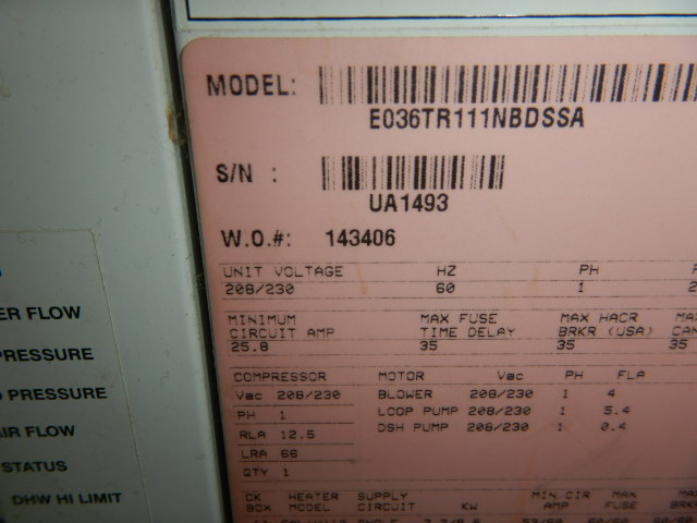

Tonnage for this Geothermal
Does anyone know the tonnage of this Water Furnace 2004 Geothermal unit, is this a 3 ton or what ?
DSCN7272 DSCN7271
3 Ton
036 = 36,000 BTU @ 12,000 BTU per ton

The output is for both sides, heating and cooling.
Depending on where this is installed, 36,000 BTU may not be adequate to provide enough heat for the home. A heat loss would need to be conducted to determine.
Here in Northern Michigan many geothermal systems have electric resistance heating added.
Not that you asked but that provides two things: supplemental heat if the geothermal can’t keep up and if the compressor ever went out, the home would still have some heat.

I agree there likely would not be enough heating in MI. I asked about the heat BTU because for that model the catalog had 50,000 BTU water loop and 41,000 Ground water for Heat output
Many variables involved as you know to reach the maximum output.
Take care
Still is a 3 Ton unit out of the crate.
Yes, accessories/supplemental heat change the equation.
