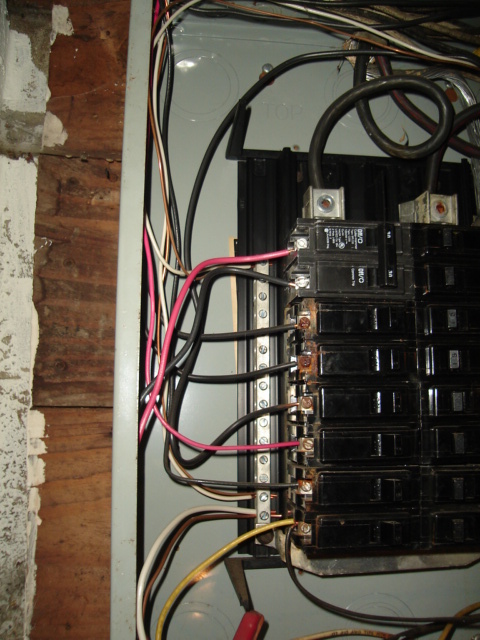

I had a realtor just call me and ask if the electric really needed evaluated even after seeing these pictures and reading my comments. Also, no main breaker was present so ALL the breakers had to be disengaged to turn off the power. No main outside either. She thought I was picky…because ther rest of the house was remodeled and beautiful and could not understand that something was found.
Ask her if she would accept that in her house, tell her to be honest.
It would be like having an antique car fully restored except for the brakes (old worn originals). Would that be picky? Seemly small issues can be devastating given the right conditions (foam flying off the Space shuttle). Some do put ridiculous items in the report (loose door knob, dirty windows) but when an item is a safety item it isn’t being picky. Its being thorough. Let the customers decide what is picky.

Rick,
I’d agree with your realtor. It doesn’t need to be evaluated.
It needs to be repaired!
We’re paid to be picky.
