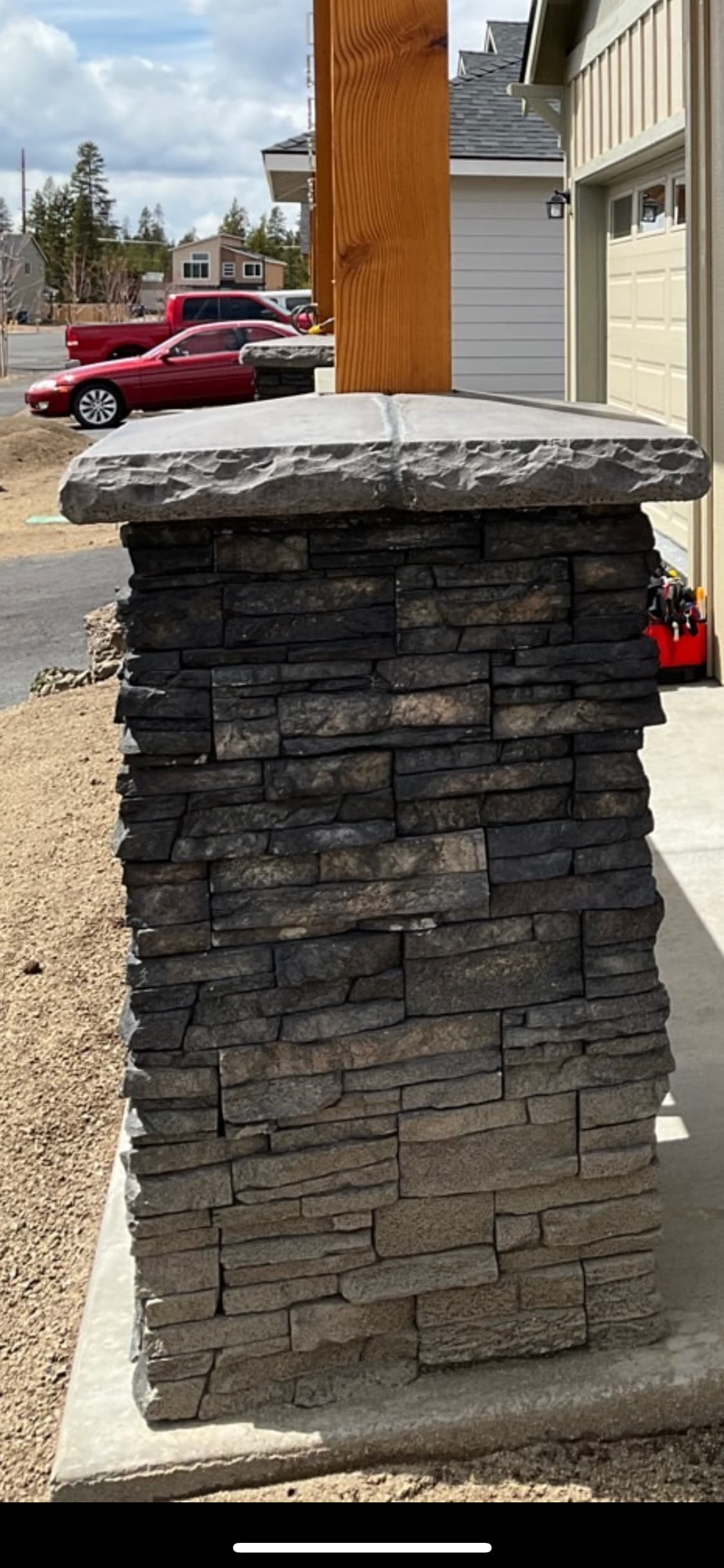

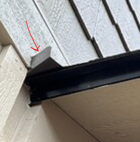

Would you call out these gaps in the trim? Also would you call out the trim gap for the roof structure? It’s new construction so I figured builder should fix it all but second guessing myself now - don’t want to call it out wrong it be too nitpicking.
On the top picture what trim are you speaking of?
On the bottom picture I would not call it out for missing trim since trim is mostly decorative anyhow. I would call it out as a penetration point into the column base of which you do not know how it was constructed. Also do you have a picture from a bit farther away displaying that base all the way to the bottom and possibly beyond? There may be other issues there as well.
Top photo needs something to prevent pest intrusion. (Pretty large gap for caulk)
Bottom photo, that lumber appears to be embedded in a “concrete well”. Unless there is drainage, that well is going to hold water and promote deterioration. That’s poor design.
Thank you that’s what I said about the top photo gap the trim needs correction to keep out rodents and the elements. The rest of that piece went to flush between The other trusses next to it so you could tell that cut for the block wasn’t like the rest. Same for the post I’ll have to check photos for drainage on the column.
Is that the bottom of the post sitting on concrete or something else?

That’s a different animal. You can’t see the base of the post which with may be sitting up on a wood to concrete post bracket. However, I would seal the gap around the post so water does not get behind or inside the column as preventative maintenance.
Great thanks - glad I called it out as a maintenance ‘no big deal just be aware and seal it up’ issue. Same with the gap in the first photo.

Does that top photo have kick-out flashing? It looks like a 2x4 laying flat
Edit–nevermind, I was able to zoom on the pic, its just shiny-reflecting the wall
Edit: He saw it :smile:
