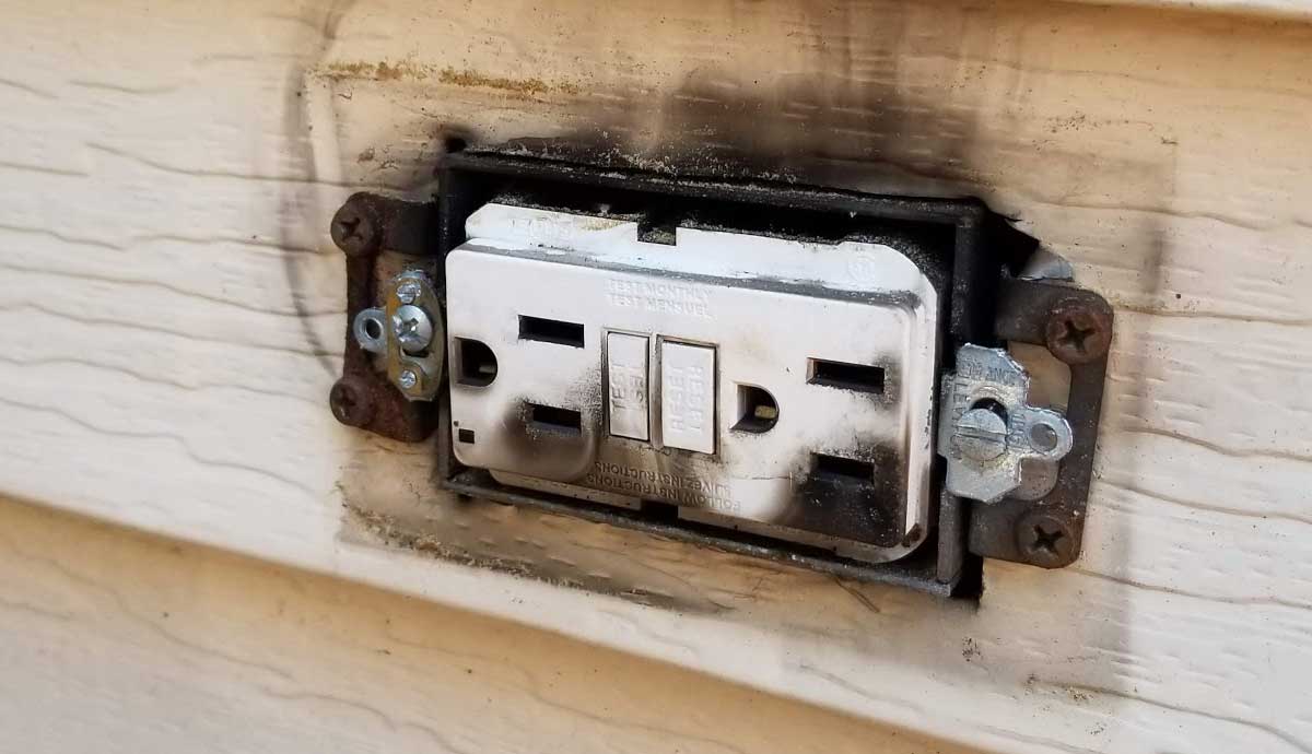

GFCI Outlet Service Life
GFCI outlets don’t last forever . This means that some of yours may no longer be protecting you as they should. Functional GFCI outlets likely save thousands of lives every year by preventing electrical shocks from wet hands, improper use of extension cords, touching bare exposed wires etc. But only if they are working.
The average GFCI outlet has a service life of only 10 years. If your home is older than that, there’s a good chance that at least some of your GFCI outlets aren’t working properly. If your area is subject to corrosion, high humidity and/or frequent storms or power surges, it is possible for GFCI outlets to become non-functional in 5 years or even less.
Compounding the problem, contractors and developers often buy GFCI’s in bulk which usually nets the most cheaply made units on the market. Using higher quality receptacles will give a longer life span so buy specification grade, commercial grade, or hospital grade. These are much higher quality GFCI’s for just a few dollars more.
