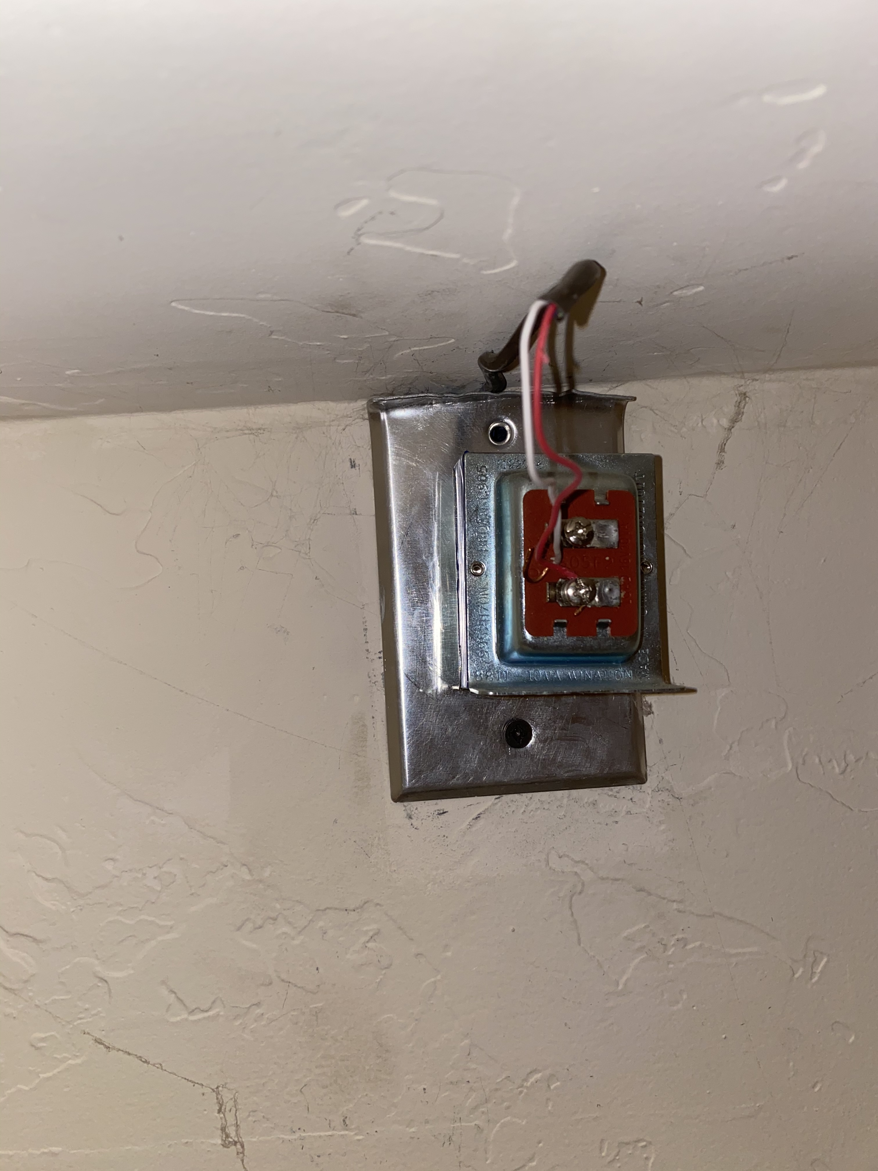

Found this in my own house and don’t know what it is… Can anyone help me identify it? Thank you.

A 120V to 16V, or similar, step down transformer. 30TR Doorbell Transformer, 16v 30va.
Typically/usually/normally see them on or in a distribution panel. Many times illegally tapped on a circuit Over Current Protection Device/OCPD, Circuit Breaker lug when dead fronts are removed.
I am curious about the enclosure and plate.
Screw missing on the plate. Top. 2 black wires pinched by the plate entering the inclosure. Hackenbush electrical installation. Look it up:-)
Interesting. Thank you. I’m now researching doorbell transformers.
It is a transformer. Output Voltages usually are in the 6VAC-24VAC range. They are used for outdoor lighting, security systems, doorbells and chimes, furnaces, lawn irrigation systems, and so on.
