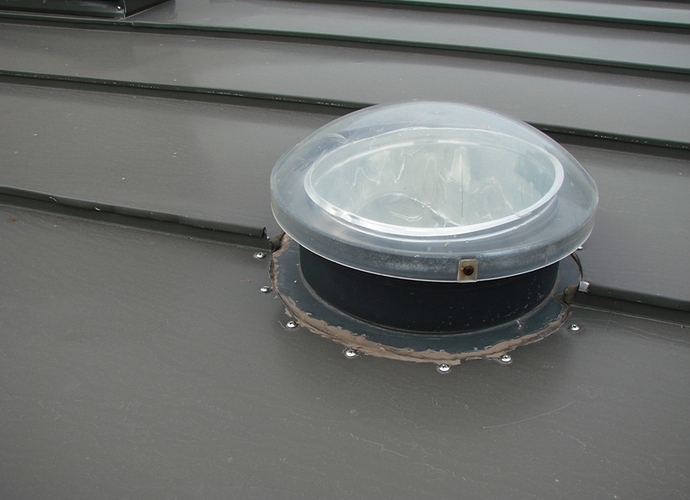

Tubular skylight on metal roof
Is this tubular skylight installed properly? I’ve never seen them installed on metal roofs and was wondering if the only way to install them is like this (without flashing) and the only thing preventing water from penetrating the the structure is caulking?
Looks like a different brand but…
http://www.solatube.com/commercial/product-catalog/solamaster-series/metal-roof-flashing.php
Thanks!
You beat me to it Stephen! I took several courses on Solatube. NO this is not correct.
