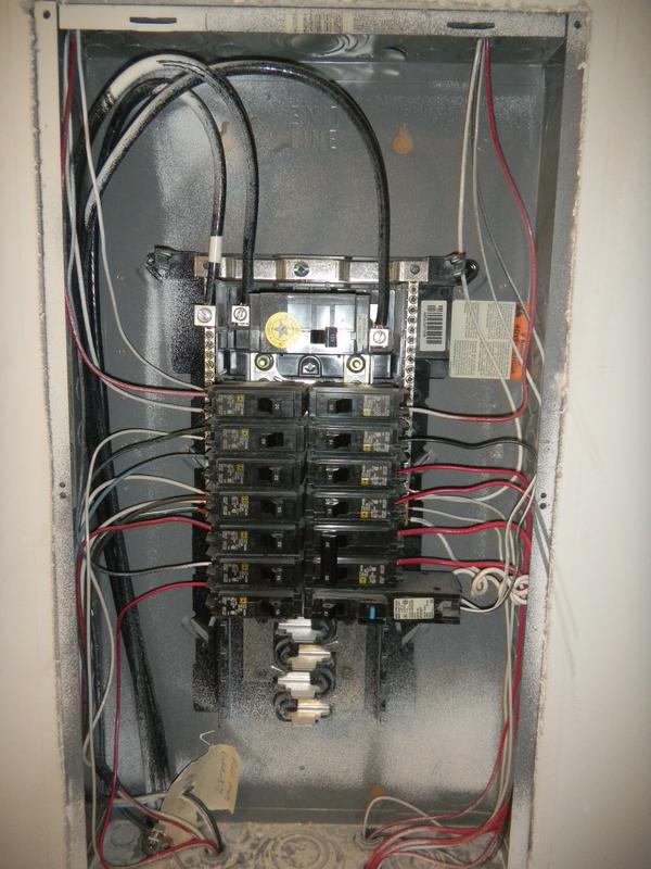

Condo inspection with a meter bank in the underground garage; each meter has its own 100 amp disconnect. I was expecting to see an RDP in the unit; but it was a regular panel with a 125 amp main disconnect. Why would there be two disconnects, and is this an appropriate installation?

I was thinking that it may be convenience. First time I have seen this and wasn’t sure. Also, I do not think this is an RDP, but can’t confirm since I don’t open meter banks of this type. There is a bond present in the unit panel.

Here are some images
Images of panel
Panel and meter images
A few images may help

This is, in fact, a MDP (sub panel) and the 125A breaker is merely a disconnect. It appears to have a bonding screw in place on the tie-bar for the neutral terminals, which would need to be removed.
I would be sure to mention the paint/plaster contamination within the panel. Also, based on the year of construction, you should have that AFCI breaker looked at to ensure it’s not a recalled breaker.

I see nothing at all unusual in the images and would only recommend the bond screw be removed.

Mike, I see a bond running from the bushing and landing on the neutral bar. Also, are the KO’s eccentric or are they concentric?
Ok, So I don’t like commenting on images that I can’t see very well but I will make some statements based on the various responses I had gleamed over in this thread.
Firstly, a bonding bushing would not be required on this remote distribution panel as shown. If indeed the raceway is being used as the EGC then any bonding jumper from the raceway to the grounded (neutral) conductor would be a violation of 250.24(A)(5). Also unless the eccentric or concentric KO’s are damaged a bonding jumper is not required due to this being a feeder supplying power to this remote distribution panel per 250.96(A).

Paul, even though a bonding bushing is not required, since it is installed and the bonding conductor is landed on the neutral bar, it is a violation. The reason I asked about the eccentric or concentric KO’s is all to often I see that they are broken and are not providing a completed path for fault current when conduits are used as the egc. We both know how common this is. :wink: Some may not be aware of how important of an issue this is when conduits are used as the egc
I agree, the bonding jumper should be removed from the neutral bar and connected to either a EGC bus or directly to the enclosure.
