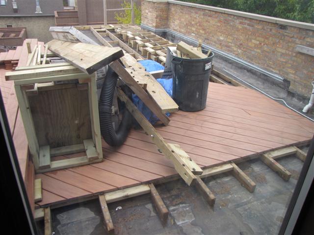

Here’s one under construction. Deck on rooftop. Already starting to leak and the deck has barely been walked on!!
