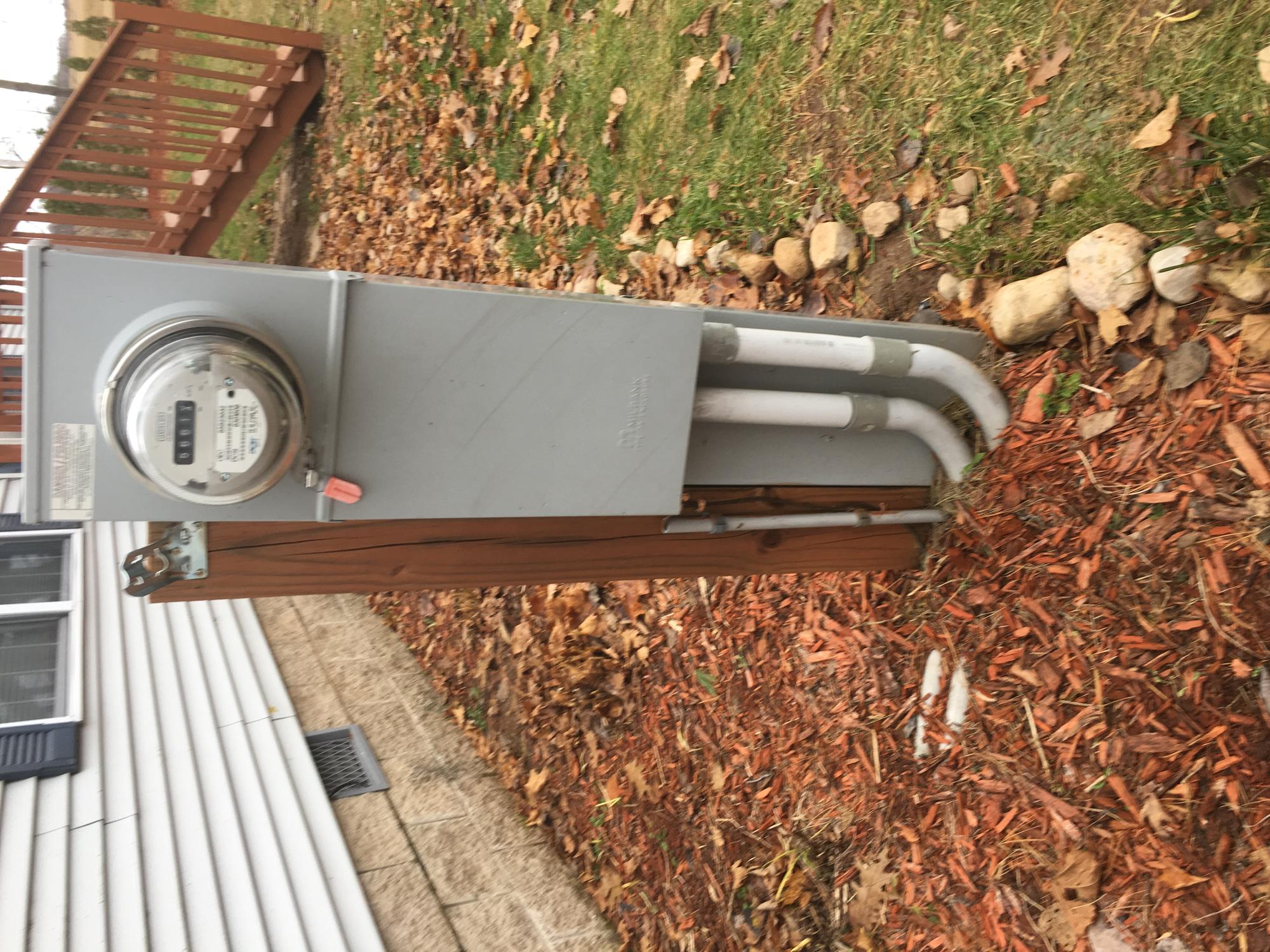

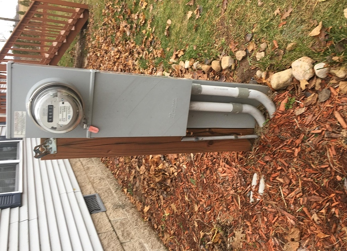

I inspected a manufactured home and found a panel in the laundry room and one in the attached garage. There was a meter on a pedestal about 2 feet away from the building. Normally in this area you can assume that the panel nearest the pedestal/meter socket is the man and the panel in the manufactured home is the sub panel.

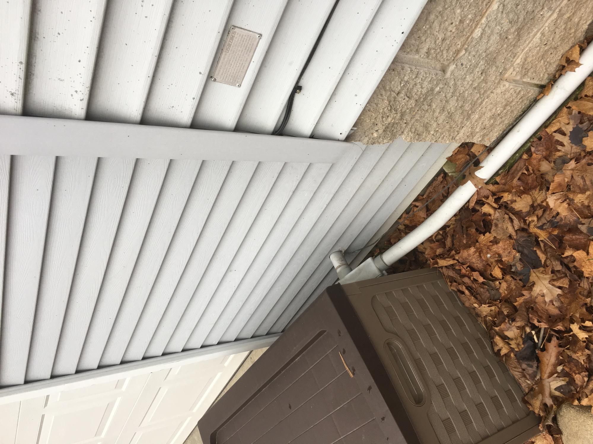

It appears there are two main panels. I noticed two separate conduit‘s coming from the meter pedestal one going into the garage and one going into the house. Neither one of the panels have the neutrals bonded to the panel ( neutrals are floating).
Can’t say I ever noticed this configuration before. Is this common or legal?
