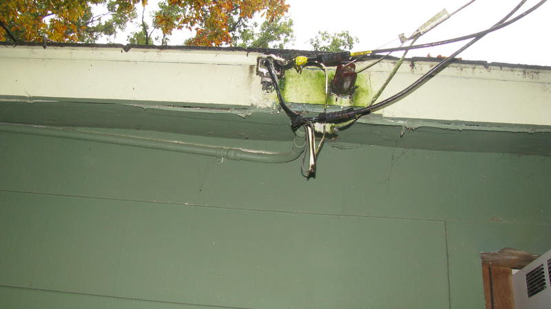

Look at this rural Missouri solution for a 60 amp fuse box with no room to wire the new electric water heater. This is NOT uncommon.
As for gas lines…no one has ever heard of grounding a LP tank.
