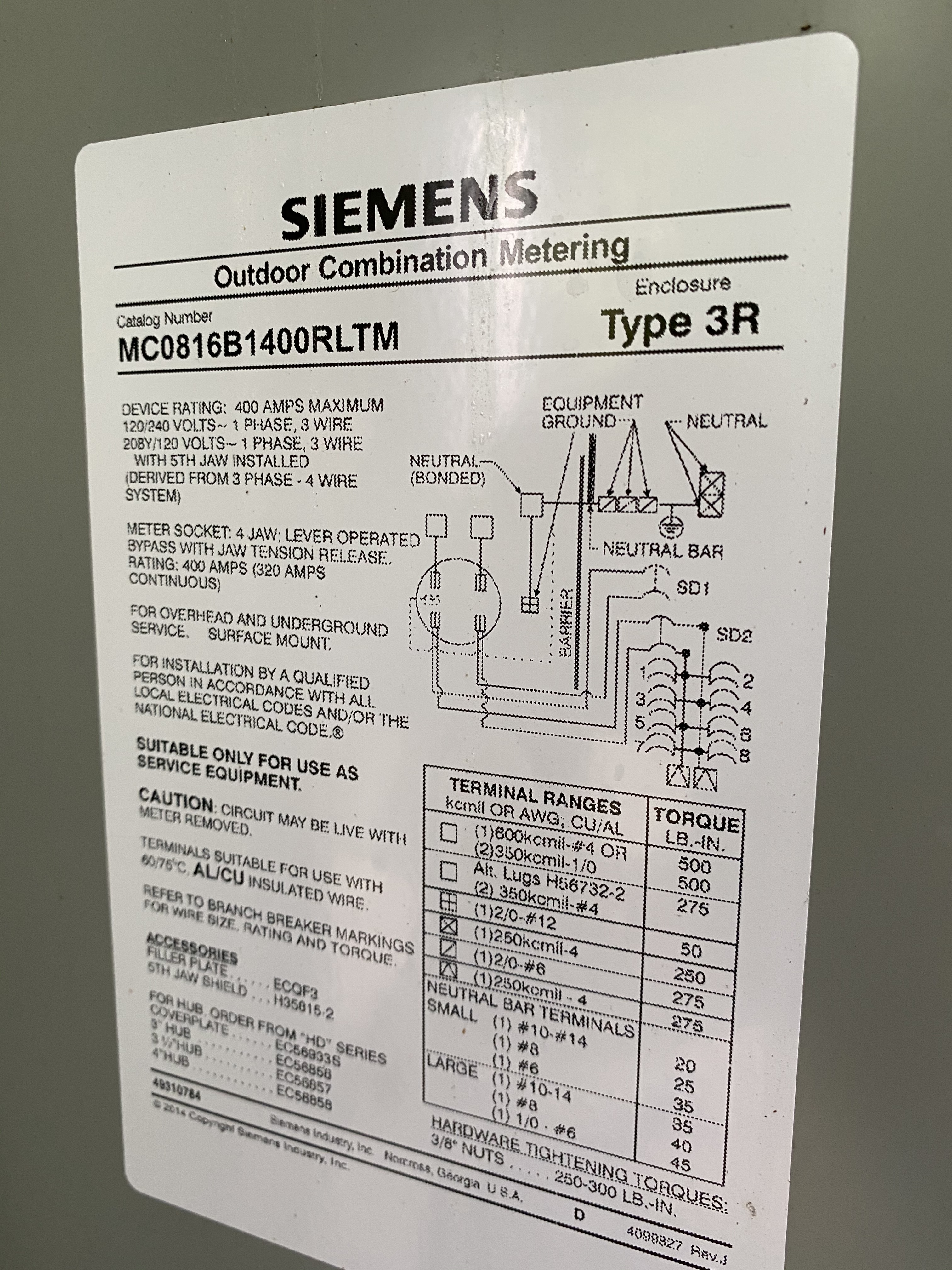

Two Panels - Two Main Breakers?
Whew…glad you chimed in on that. Double taps can mean two distinctly different things to Electricians and Home Inspectors.:mrgreen:
Your doing a great job here on the boards Robert. Thanks for all you do to help the HI’s. They have a special place in my heart…not all associations mind you…but INACHI yes.
Yep…and then the age old argument begins in terms of the verbiage (in terms of the panel setup being shown by the OP) “for service conductors supplying the ENTIRE load associated with a one-family dwelling” and I will stop at that one. Would each SE Cable(probably Cable) meet the intent of 310.15(B)(7)…or better said does each panel’s service conductors supply the entire load…nope.
So in this case the home would have 350 Amp service?
