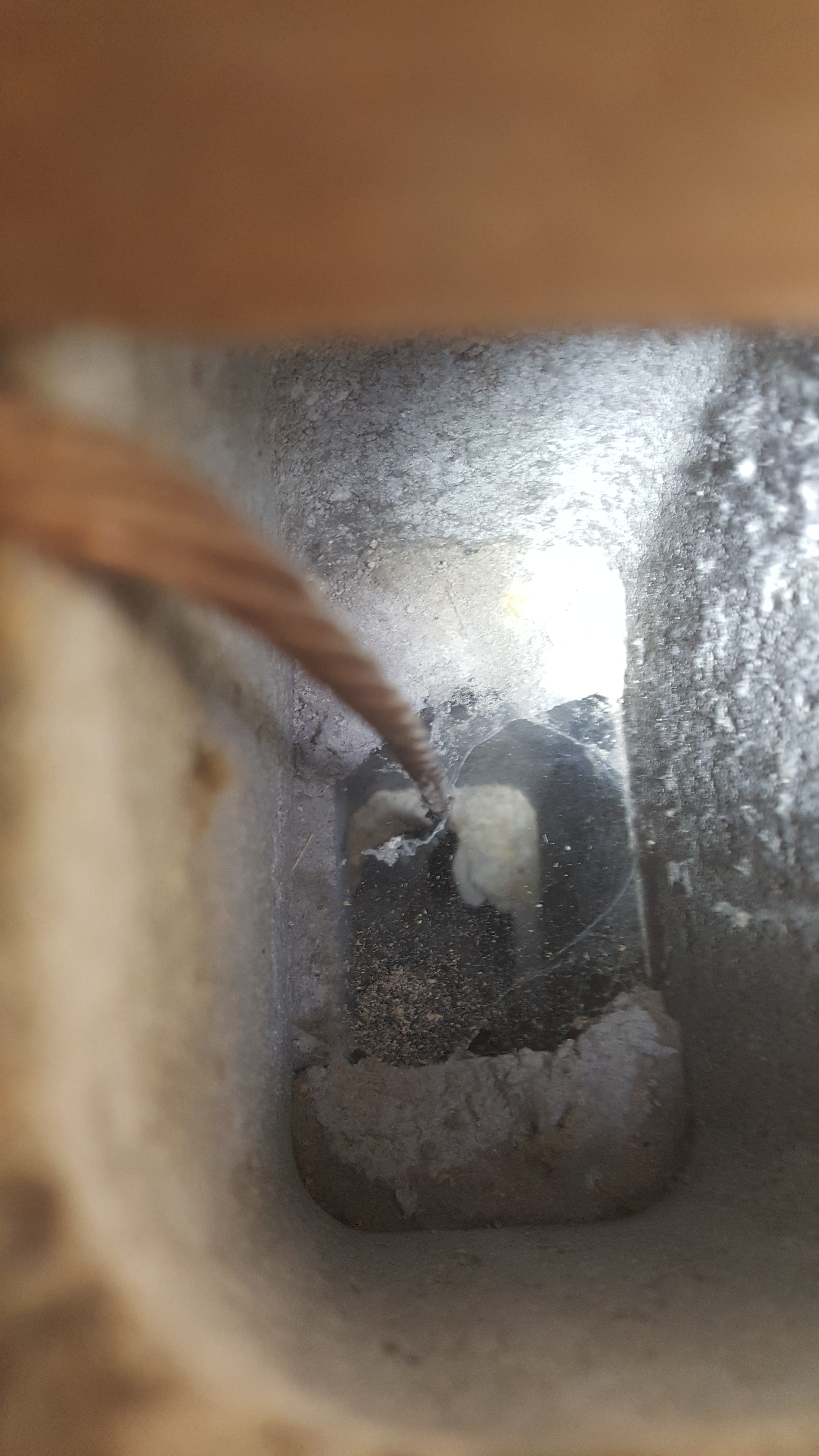

Was anybody doing CEGEs in residential in the 60s? I know Mr. Ufer invented the system during WWII, but I’ve never seen one in an older residential structure. Isn’t this more likely a common ground rod electrode through the concrete floor?
I took a look at the 1965 and 1968 NEC a concrete encased electrode first appeared in the 1968 NEC but they weren’t really used in homes until decades later.
Interesting that this isn’t actually a Ufer, but just a ground rod cemented in concrete. Just figured I’d add the picture I got of the copper going into the foundation.
