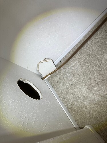

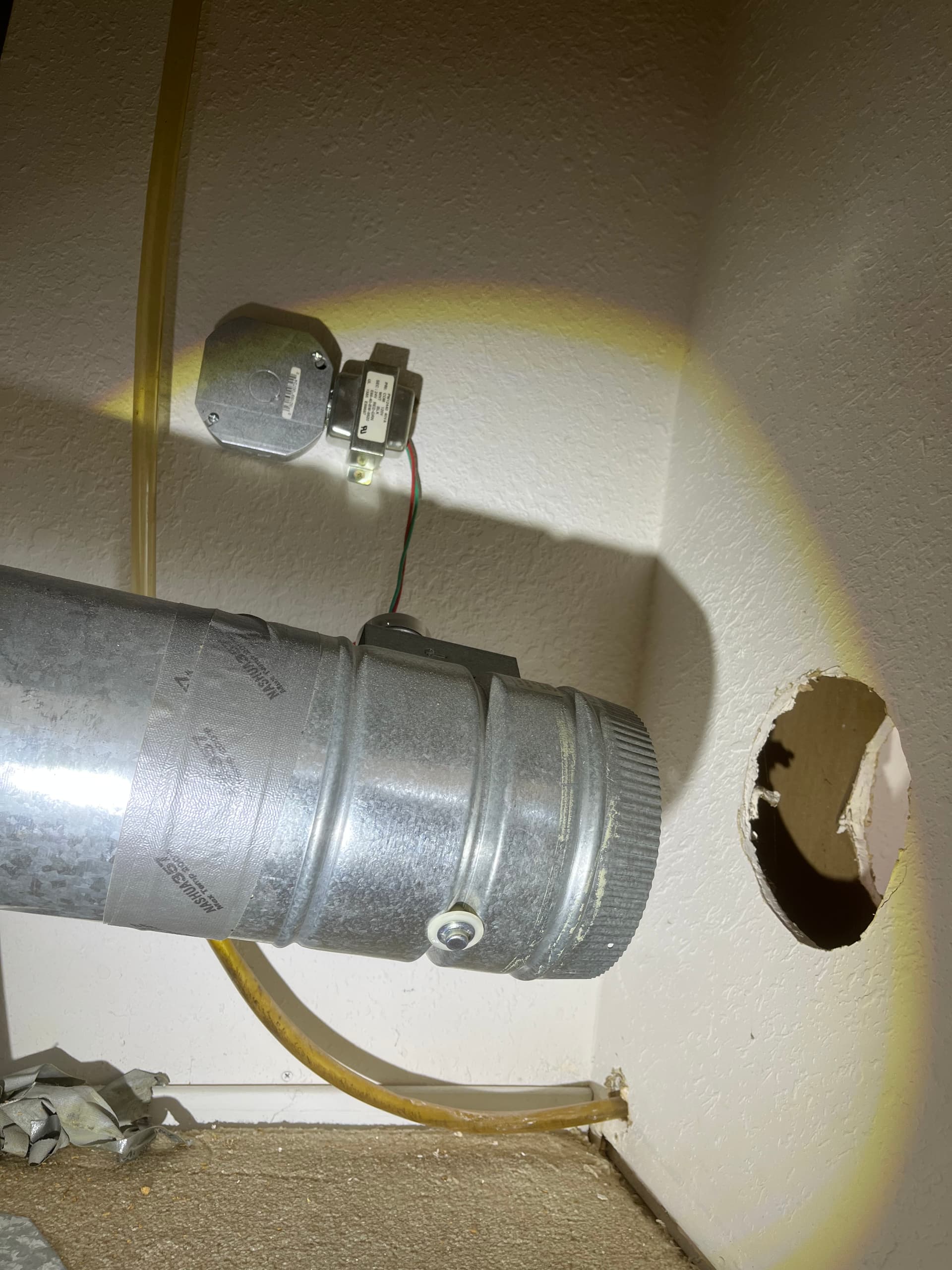

Can anyone tell me what this is? This was found in a 2nd floor bedroom next to a closet and behind an access panel. There is some unexplained ductwork that connects into a larger rectangular ductwork that goes into the wall, a small transformer, and also what appears to be a dirty condensate drain line, but I did not see any condensate producing appliance nearby or in the attic. There was a gas furnace located in the basement of the home, and a plenum in the attic, roughly above this area.

Was there a line-voltage thermostat or a switch that did not seem to go to anything in the area?
<div class="post-metadata">
**Author:** ![jlim2](https://sea2.discourse-cdn.com/internachi/user_avatar/forum.nachi.org/jlim2/32/250855_2.png) [@jlim2](https://forum.nachi.org/u/jlim2)\
**Post date:** [September 5, 2025, 3:24am UTC](https://forum.nachi.org/t/unknown-bedroom-closet-duct/260413/3 "2025-09-05T03:24:25Z")
</div>
The only line voltage thermostat was in a basement bathroom. There was a nearby switch that did not seem to do anything.
**Author:** ![jspencer](https://sea2.discourse-cdn.com/internachi/user_avatar/forum.nachi.org/jspencer/32/172267_2.png) [@jspencer](https://forum.nachi.org/u/jspencer)\
**Post date:** [September 5, 2025, 3:28am UTC](https://forum.nachi.org/t/unknown-bedroom-closet-duct/260413/4 "2025-09-05T03:28:30Z")
</div>
> [@jlim2](#):
My guess is that the switch opened the damper to control conditioning of a room that was not used that often. Normally turned off until the adult kids come home for a few days at Christmas. Something along those lines anyway.

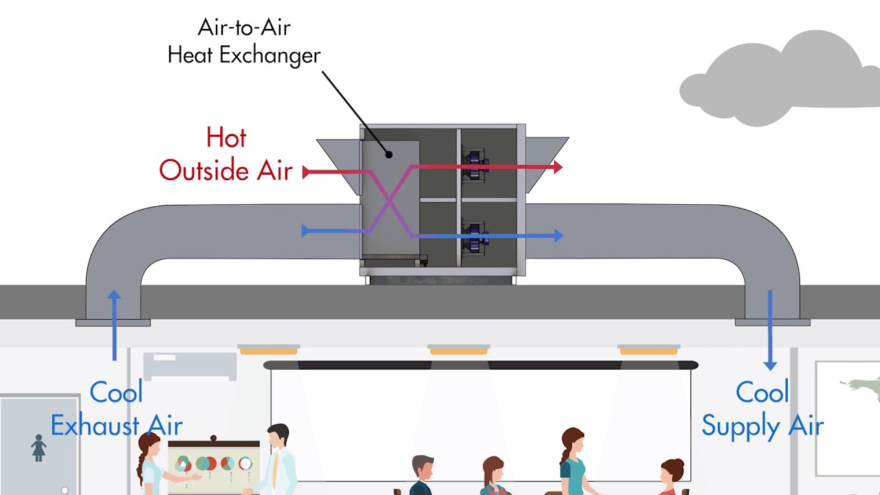

That box in the attic looks like an air exchanger.
**Post date:** [September 5, 2025, 3:00pm UTC](https://forum.nachi.org/t/unknown-bedroom-closet-duct/260413/6 "2025-09-05T15:00:56Z")
</div>
> [@mgratton](#):
Yup… HRV/ERV.
[![](https://global.discourse-cdn.com/internachi/original/4X/7/8/c/78cba08d499840a47019021547e0411812eda0f9.jpeg "ERV & HRV Units Explained") ](https://www.youtube.com/watch?v=CDCu0IbEn8Q)

Afternoon, Julian. Hope to find you well.
Please, list the HVAC equipment please. Make/Manufacture/Model and serial numbers as well.
Clearly some ductwork has been disassembled in the top image. Remaining is a vent/duct damper with holes in drywall. Likely an old install.
The second image looks like a condensate line on the floor.
3rd image is a damaged heat recovery ventilator or as Marcel explains an Air Exchanger but that is old-school for HRV and ERV Heat and Energy Recovery Ventilators.
Observation: Damaged heat recovery ventilation system.
Recommend: A licensed HRV contractor/ technician further review and repair or replace the air exchanger and duct work. Act upon any recommendations therein.
