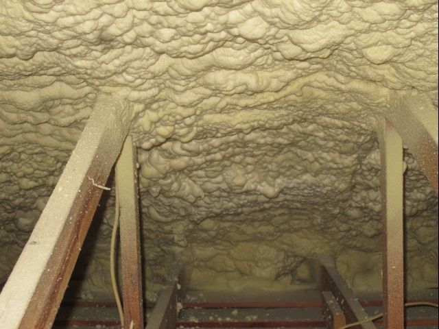

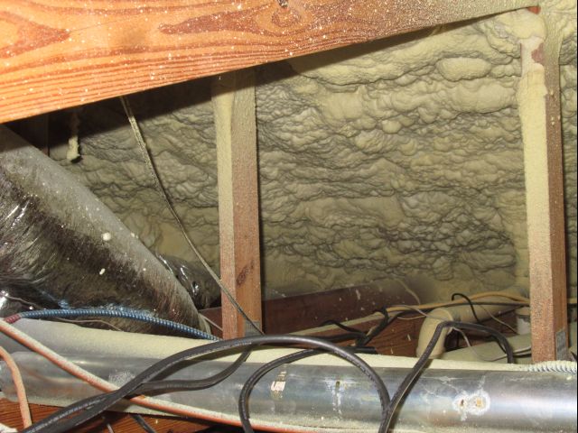

This 2006 roof is in the HVHZ.
The buyer says: whadda ya mean you can’t see any straps?
I’m gonna get killed with a rate. Just fill out your report, don’t worry about no pics. How silly!
I can’t view the spacing or shiners either.
Even if I removed & damaged the foam (seller won’t let me touch it) in selected areas,
the chances are still no shiners to measure. ☹

No docs of any kind available. Just the permit that doesn’t address it.
House was built in 1974.
The foam is everywhere! They went nuts.
The only option I can figure is after closing, the buyer can then have me come back to tear up the foam (with a signed release).
Even then, something could come back at me.

Report what you see, the credits are the underwriter’s problem.

1974, ok, no FBC there. If they did not take photos before the insulation went in, then they are out of luck on the attic portion. With a 2006 re-roof, the decking is most likely not renailed either.
