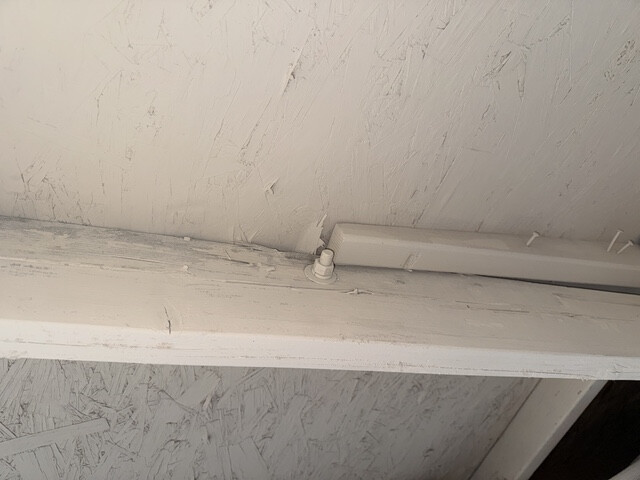

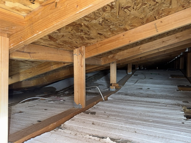

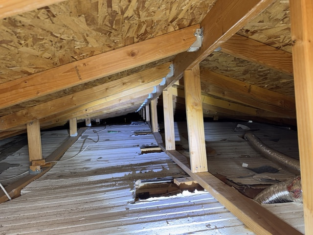

I was recently asked to inspect a roof in california. the manufactured home had a original metal roof. the contractor did not obtain a permit. he then installed a roof structure over the top of the home. the center posts were in the middle of the single wide home. there are no load bearing walls or other support features. the rafters are bolted to porch roof rafters, there are post above the exterior walls that might support the weight. I am stumped as what to recommend. go through permit process? suggest they get an engineer opinion?

We are not code officers. We are not code-officer-adjacent, even. We’re not here to promote or police the acquiring of permits. I see things all the time that have/would passed inspection that I make comment on for workmaship or performance reasons. If you see a poorly-built roof, tell your client that. People don’t need structural engineers to add or remove a roof.
Engineer, not necessarily for a simple roof like this one. This is a residential house, and that roof can be repaired by a competent carpenter. An engineer will do no good directing an incompetent carpenter. My comment for something like this typically is:
Observation: Numerous issues observed with the roof structure. Examples include: 1) Center posts were in the middle of the single wide home. 2) No load bearing walls or other support features present 3) Rafters are bolted to porch roof rafters. 4) There are post present above the exterior walls that might support the weight. Recommendation: Contact a reputable and licensed building contractor with roof framing experience for further evaluation and repair.
That’s where I leave it. I don’t care who did the work. I’m simply reporting what I see and leave it at that. I definitely will look for other issues: Roof sag, ceiling sag, structural failure. If any of those items are observed, I’ll mention that. If no failure is observed, that is mentioned.
I categorize my findings, an important component of the observation; Major or Needs further evaluation. That alerts my client to the importance of the finding.
I don’t word any of my comments with a connotation suggesting, “The person who did this work is incompetent and a hack.” I try to write non-judgmental comments. Stick to the facts.
As an edit, if that’s a 16’ wide manufactured home, the roof issue probably can be fixed easily by simply running collar ties across the lower 1/3 of the rafter span, then eliminate all the vertical posts under the ridge and rafters. The fastening method between the collar tie and rafters might need engineering or the expertise of a roof framing (hand framing) carpenter.
Another edit: In addition to the collar tie, a vertical king strut from the collar tie up to the ridge board will create additional strength. The size of the collar tie will be important in this case.

Thanks for the comments. I feel bad for the customer but yeah terrible job. Collar ties recommendation done by license contractor is the best recommendation it seems.
