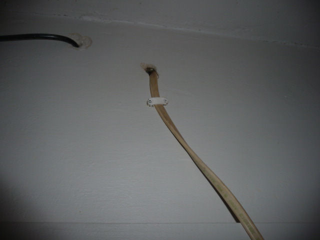

I was in a 1925 1-1/2 story home. One of the side attics was converted to a talk-in closet (better be short) but I found a romex feeder originating from an original 2-wire (K&T) receptacle and the ending higher up the wall with a 3 prong receptacle to power a TV. The feeder was stapled, but was a D-Y-I job. What is the opinion?
No, this was not an ungrounded GFI new receptacle.

What you are showing is a Branch Circuit just to be clear:)
Is it subject to physical damage? If yes, sleeve it in an approved raceway of the exposed portions to protect it. Is it secured to the box properly…can’t tell. Is it supported not exceeding 4 1/2’…maybe, is it secured to the box? is their a BOX?..lol
Many potential variables with in the unknowns of this image…:wink:

It’s a plaster and lath wall separating the bedroom from the closet. I belive the lower receptacle has a box since it is the original 2-wire receptacle. (K&T) is feeding this from the attic. You are correct, this is just a branch circuit feeding the receptacle that powers the TV on the upper bedroom wall.
Don’t know if there is a box on the new receptacle. Taking off the cover plate is going beyond the SOP. :slight_smile:
It could be subject to damage depending on how much stuff the client is going to stuff in the closet. A possible solution would be to have a licensed electrician enclose this in a vinyl raceway for protection but who am I to make suggestions like that LOL.

I found a pic of the TV receptacle (the upper) from the bedroom side.
Exposed electrical wiring inside the house would not pass muster here.
Call it out. :smiley:

Now the issue ( without going over SOP…lol ) would be protecting it if it was determined to be subject to physical damage. I don’t believe a strip of plastic would protect it…Code would call for :

The ungrounded circuit should not have been extended. A new circuit with a grounding means should have been run.
I would not unless it says it is listed to protect from physical damage…lol If the location is not subject to physical damage then sure…why not. Howewver, install NM Cable in it and it not be for physcal damage and well…thats another story.
It is all a moot point anyway as Jim Port pointed out, as code prohibits extending an ungrounded circuit.
Same here. Either remove it or redo it so the wire is inside the wall cavity.

Even though plaster can be a pain to work with as is concrete, I guarantee there were no steel reinforcing bars as described in 250.50! I called it a safety issue to be evaluated by a licensed electrician based on extending an ungrounded branch circuit.
