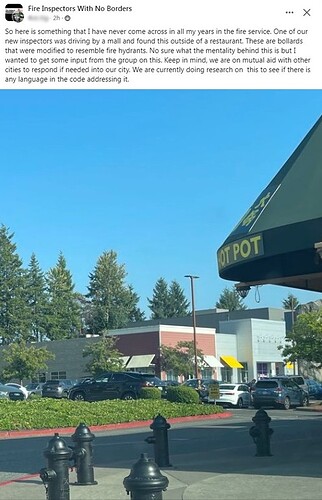

Thought I would share…
Well, something I have not seen before, and not even sure what my actions would have been prior to seeing this post, is any, if I had ever come across these during an inspection…
(As posted on Facebook… not mine)
I would likely come up with some professional way of saying this was really stupid in my Fire and life safety section of the report.
I seen that on Facebook too. Reading some of the comments, it sounded like a black hydrant is a universal sign of a dead hydrant. I never knew that before. :+1:
