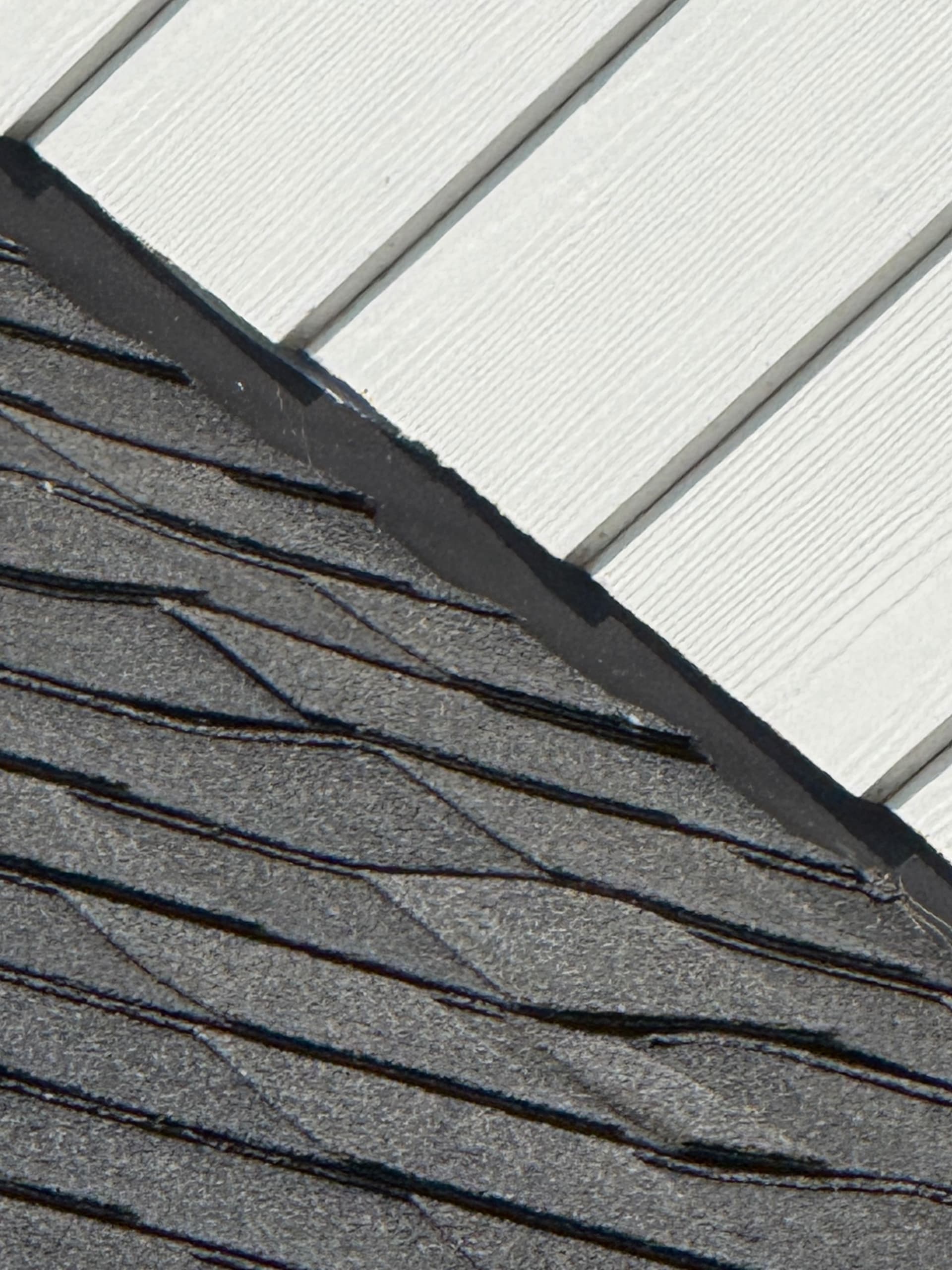

New construction. Is this a new way to do flashing? Judging by the little bump running up the roof, this strip of flashing is folded like this all the way up. I’m guessing it’s intended to channel water toward the gutters. It’s on other homes in this subdivision near Nashville TN. Any comments?

Must be a Nashville thing, because I inspect new builds all the time and have never seen that around here.
I would write it up as improper flashing installation resulting in the shingles not laying flush on the surface. This condition makes the shingles prone to wind damage, not to mention it may likely void the warranty on the shingles.

That bend is called a return, sometimes referred as a hem, except for me a hem has one more turn.
That return is lifting the shingles which interferes with shingle adhesion and make them prone to storm damage/wind lift. It will also affect roof drainage with concentrated flow vs a wider sheet flow.

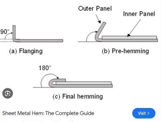

Great narratives.
I hope you do not mind me adding to this, Brian but I concur. A return would be a good narrative.
If this was a sheet metal hem for sheet metal work it would be referred to as a pre-hemming panel to accept an inner panel in a hemming process.
 ![sheet metal pre-himming bend](https://global.discourse-cdn.com/internachi/original/4X/c/d/7/cd7037a9f22b918b9c6e828feabadb371bdcfda2.jpeg)
Been some time I work with sheet metal and tin smiths.

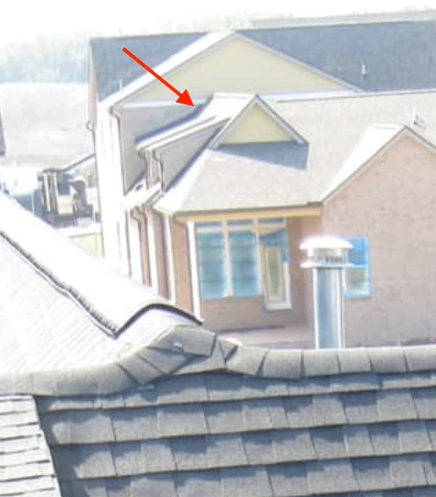

The ridge shingles over those dormers are wild and just do not look good. The shed roofs on the dormers should have ended about two feet or more below that ridge! It’s just a poor design!
<div class="post-metadata">
**Post date:** [September 18, 2025, 1:43am UTC](https://forum.nachi.org/t/unusual-looking-step-counter-flashing/260743/18 "2025-09-18T01:43:41Z")
</div>
> [@spatterson5](#):
Yes, more like these across the way:
