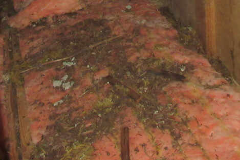

Inspecting a 1977 house today and noted the service mast is made from flex conduit, and attached to the chimney. In my area most if not all masts are a steel pipe. I also thought it to be unusual that the mast is so far back from the meter socket. Any thoughts on whether or not this is properly done?
I would flag it. And why aren’t you up on that roof? Lol.
And that’s the part with the least amount of moss… :joy:
Gonna have to mow it soon.
Nothing should attach to a masonry chimney. The fact that the local POCO approved it is strange to say the least. It is possible an electrician did it and the POCO was not involved. Where the heck do you live :smiley:
I wasn’t aware that the mast was allowed to enter the wall BEFORE the meter socket.
Around here the POCO has on occasion allowed attachment to a solid masonry chimney. The issue with what is shown in the photos is more about the unprotected conductors run through the attic than the raceway.

Interestingly, the inside looks just like the outside.
It appeared that at one time there was Ivy growing through the wood siding and into the attic; lots of dead vines.
