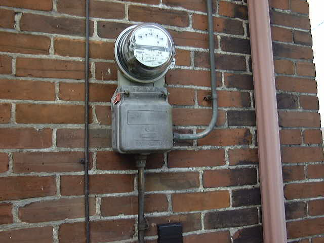

This service is Pyrotenax July 30 2004 ,The only one I have seen.
I put in many miles of Pyro starting about 1956 .
http://www.tycothermal.com/assets/Americas/English/Document/Installation%20Operation%20and%20Maintenance%20Manuals/4330/H57987_IW_IOM_1206.pdf

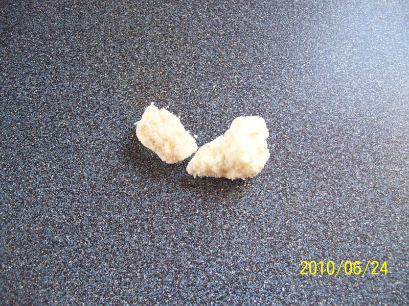

A 4 gauge punt gun in a home we inspected for the owner ,Picture with his permission and No I will not tell you where . http://www.youtube.com/watch?v=-kdG2dwNb60&feature=related This gives you some idea how they could shoot 100 ducks at once in the late 1800s

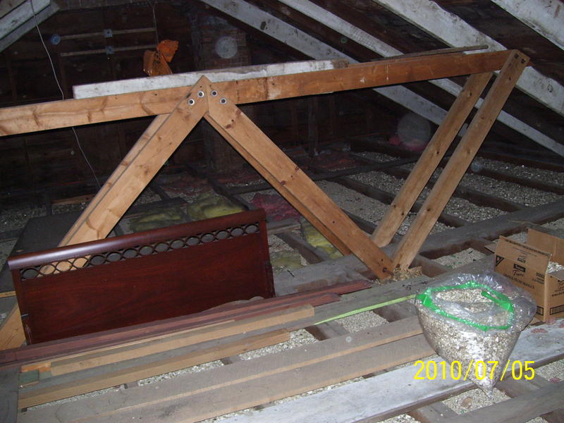

This is a reverse truss only one I have ever seen. Very large old Living room still has some sag in the ceiling apparently this removed about 7 inches of sag.
Yes I wrote up the Vermiculite.

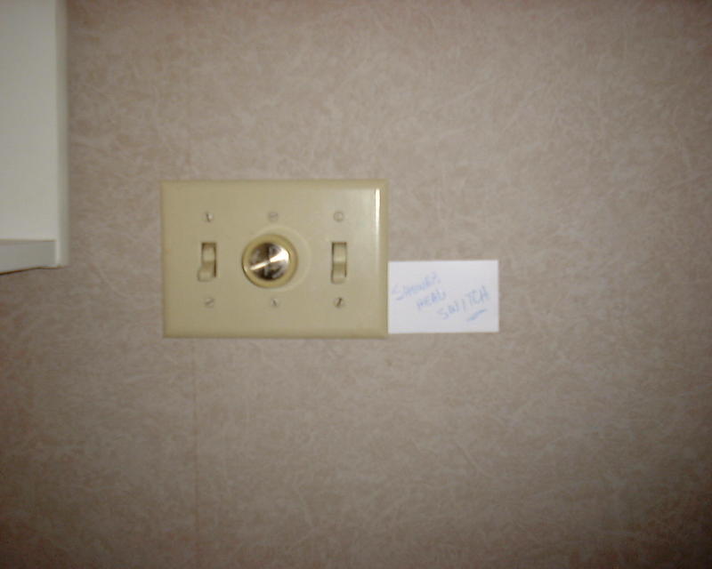

Second set of Pictures was In a home with many college students .
The land lord had used the controls from a clothes washer to control the water temp to about 100°f in the shower .
The switch was about 12 from the shower . This was an accident waiting to happen .

(Joe Funderburk, CMI) #12
Sounds like it may be in a flood plain. Better put a little comment about that to CYA.
(Joe Funderburk, CMI) #13
Not sure I would have called that out. What’s the difference between that situation and getting out of the tub with wet feet and walking to the switch 3’ away? Here’s the code and commentary (which supports your decision).

(Roy D. Cooke, Sr) #14
Sorry I will always call this out being able to stand in the running shower and turn of a switch could get exciting as well as the complete system is wrong .
(Mark Ellison, CMI) #15
in Canada -
switch cannot be within 1 metre (39") of tub/shower surround.
Receptacles are the same, except where the room is so small 1 metre is impossible, in which no less than 50cm (19") is allowed.
