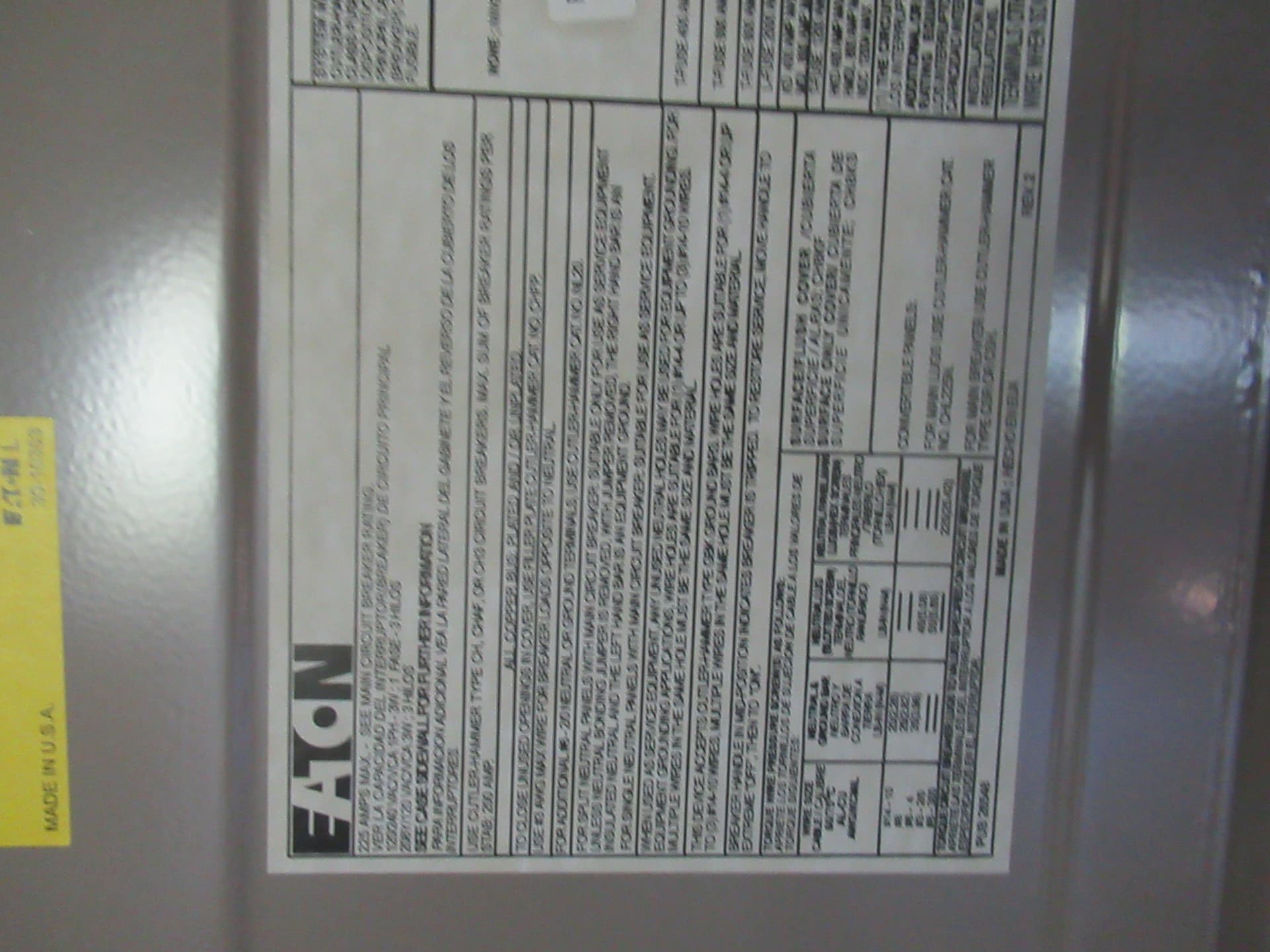

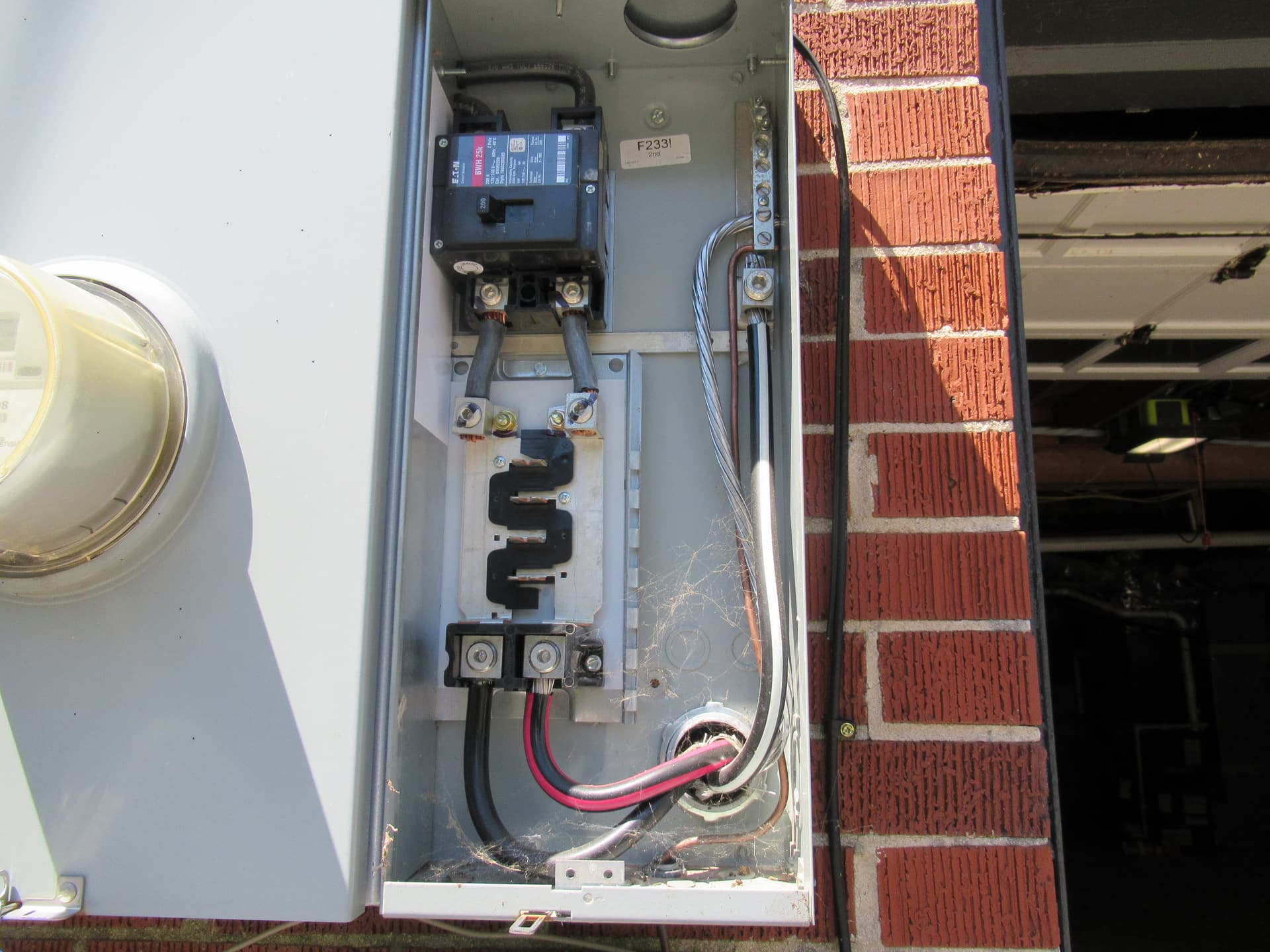

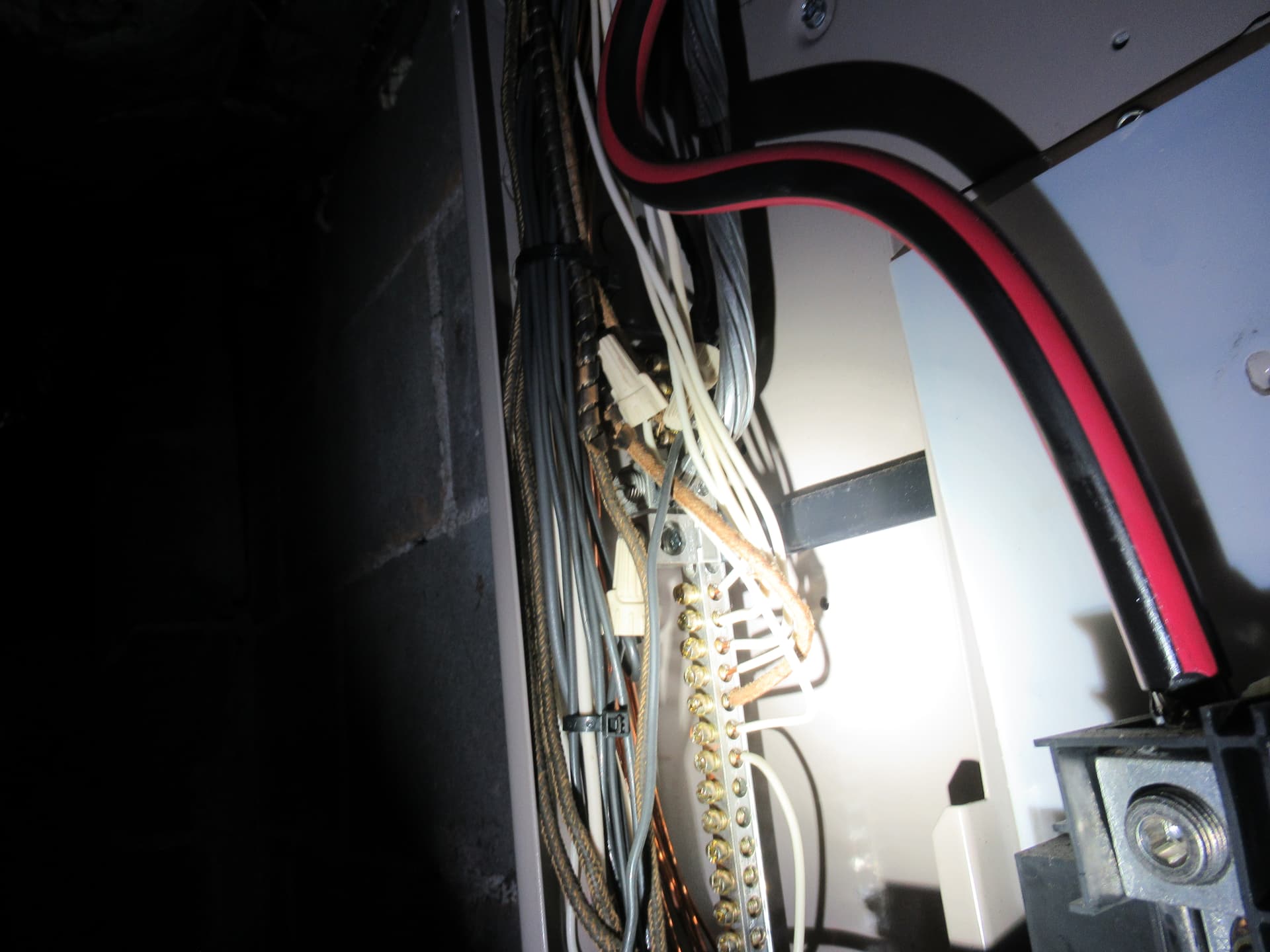

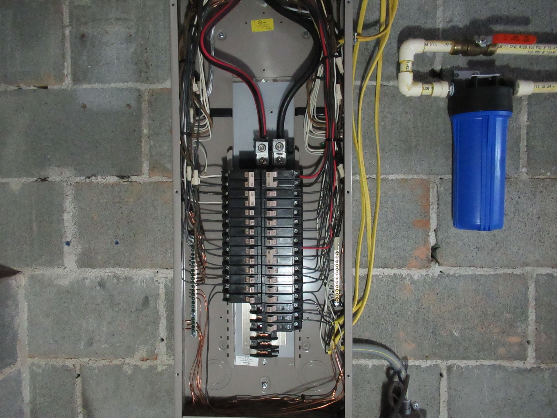

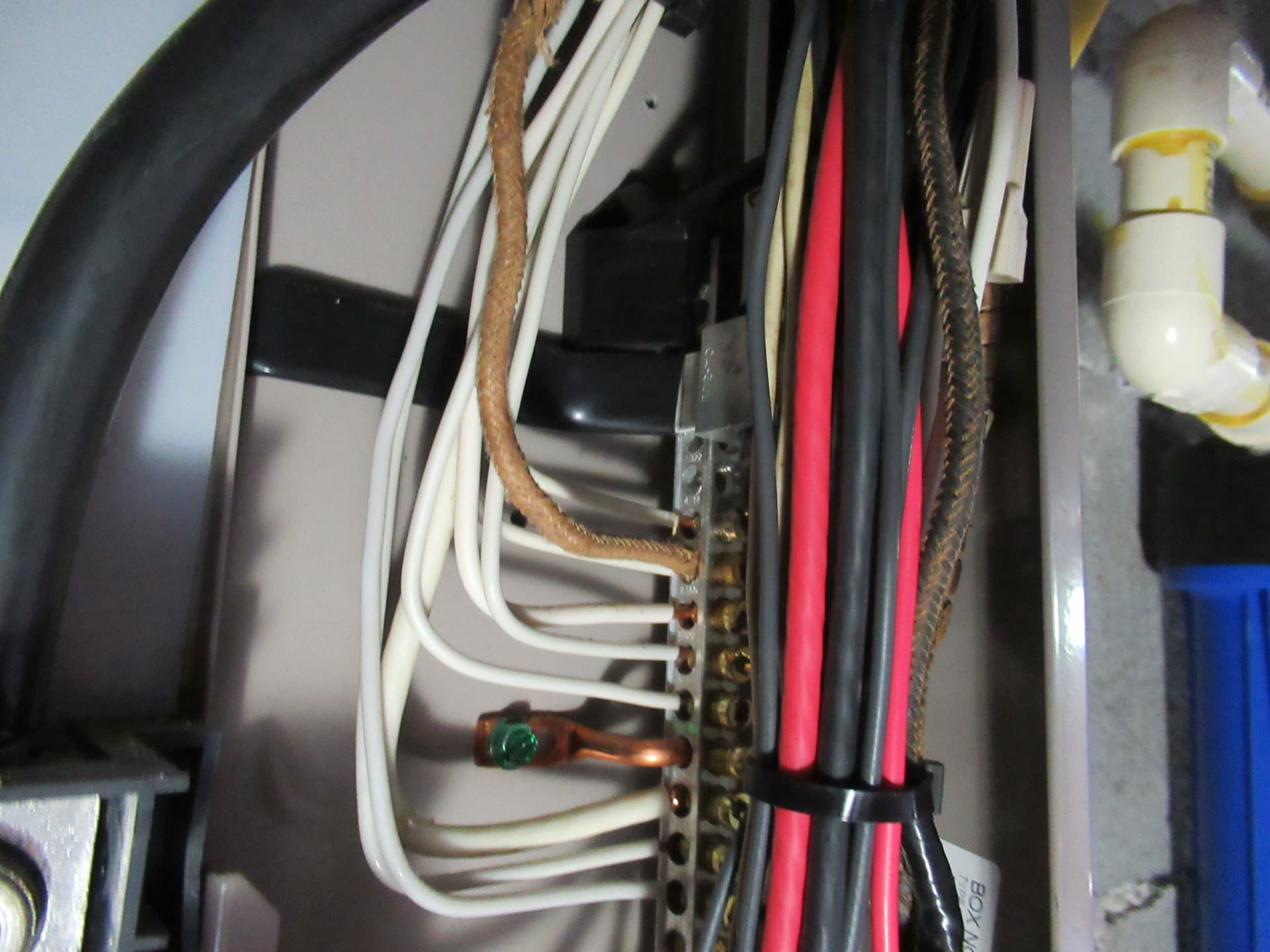

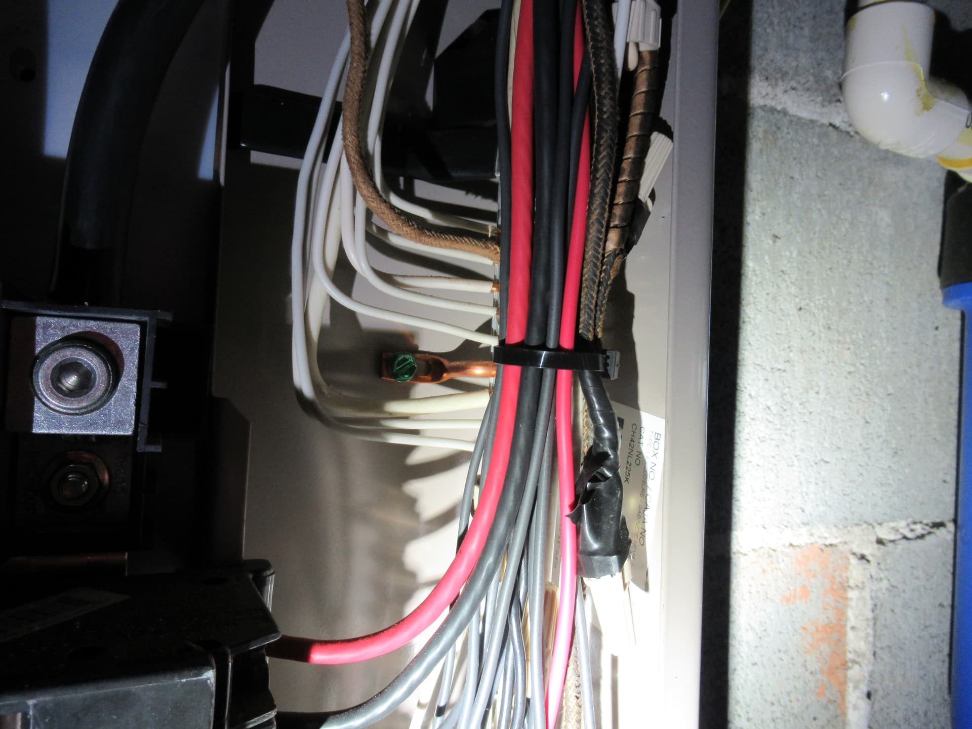

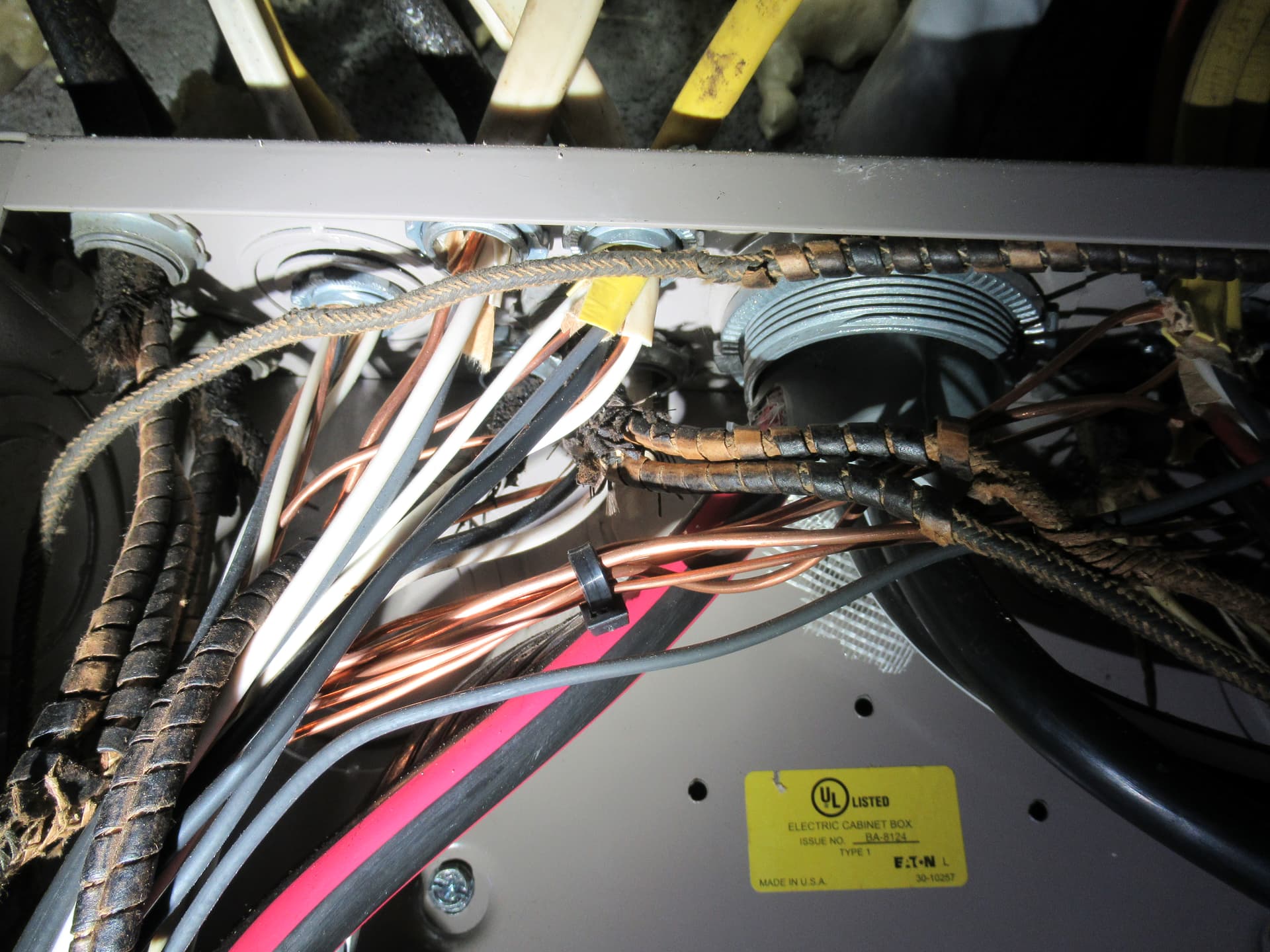

1948 home with newer panel (Eaton) and electrical service. 200 amp disconnect at the meter outside and panel located in the garage.
A few observations and questions.
1. All receptacles downstream were ungrounded except for GFCI
2. All receptacles were 3 prong and not labeled “no equipment ground”

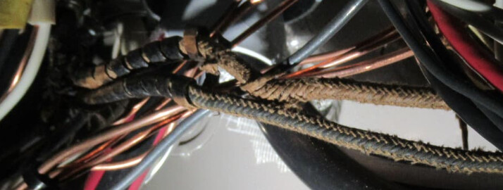

3. What do you think about the condition of the old sheathing and has anyone ever seen this sheathing “wrap” before?
4. Does this panel look modified? Is that plastic behind the breakers normal?
5. Can anyone confirm the neutral and ground is separated?
All feedback welcome including narratives. ( I have more photos 🤪 )

1, 2. When they upgrade panelboards here, the permitting authority typically requires the upgrade of the receptacles to GFCI protection (with stickers indicating no equipment ground) .
3. That looks like common spiral wrap, often used for LV cable or wire management.
4. Not familiar with the plate over the bus bars, doesn’t look modified though.
5. There is a bonding strap in your photo, and it should only be present if it’s service equipment. This is downstream panelboard.

> [@ddagostino](#):
> 1. There is a bonding strap in your photo, and it should only be present if it’s service equipment. This is downstream panelboard.
Thanks for the information!

I think I found a Cutler CH load center with that center plate
It looks like yours had the main breaker removed.

> [@bcawhern1](#):
> Does this satisfy the bonding requirement?
If it isn’t service equipment (or point of disconnect / “main panel”) the neutrals and ground (grounded & grounding) need to be isolated, not bonded.
<div class="post-metadata">
**Post date:** [July 16, 2022, 2:58am UTC](https://forum.nachi.org/t/updated-electrical-panel-with-concerns-please-comment/217851/7 "2022-07-16T02:58:12Z")
</div>
> [@ddagostino](#):
> If it isn’t service equipment (or point or disconnect / “main panel”) the neutrals and ground (grounded & grounding) need to be isolated, not bonded.
Yep…this is where I am concerned. The main service disconnect was at the meter outside. This panel is 25 feet across the garage on an interior opposing wall. I have difficulty determining if they are isolated (as a generalist 🙂 )

The conductor insulation and that wonky low voltage spiral wrap should be addressed, along with the bonding.

The spiral wrap was part of the old AC cable. It was between the metal sheath and the conductors.
The panel should not be bonded.

> [@jmilby](#):
Thanks Jim, from the photo’s would you say that it is bonded and needs to be corrected?

The bond strap near the tywrap looks to be installed on a neutral bar and should be removed. This panel should be fed with 4 wires.

- Some of the oldest cloth based wiring was apparently moved from an older panel, to a new one. The insulation was protected with a spiral wrap which is not itself a problem, but in some cases the threads on the cloth wiring are showing signs of unraveling. If these wires unravel in a place where wires can touch, this can lead to severe consequences.
Strongly recommend this electrical system be checked by an electrician skilled and used to working with older electrical systems. Strongly recommend mapping which circuits use the oldest wire, and evaluating if there are other options should that wiring need replacement.
