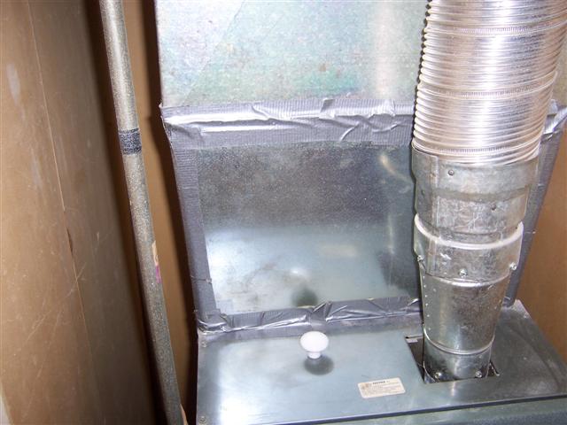

I think you need to note that althought Duct Tape is spelled like Duct, it does not mean that it is for Duct joints. If you know what I mean.

I am still trying to figure WHY they used that duct tape? I planned on calling it out, but couldn’t figure why they would do it.
I can tell you why they used the duct tape because there are no S’s and Drives below the tape where the transition joints are. Bad install:(
I love this message board, I learn every time I read a post. So I will ask. What do you mean by “S’s and Drives”? Are they like transition strips?
Greg: The two connecting joints of ducts have their ends rolled into the shape of the bottom 1/2 of a S and the drive is a strip of metal that slides down the two S’s holding the two sections of duct together and is air tight you don’t need any tape. That is the way all rectangular duct is suppose to be joined together.

It isn’t important WHY the dipsh8t used the duct tape…what is important is that he shouldn’t have.
I planned on calling out the duct tape, but in the process learned about S’s and Drives. This message board is worth its weight (if it had any weight) in Gold :mrgreen:. But I still think you can use duct tape to fix glasses :bandit: :|.)
