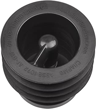

I am currently working on one of my writing assignments and decided to use some photos of the floor drain in my upstairs utility closet, where my HVAC and Water Heater are located. While looking down the drain I noticed what looks like a plug of some sort in the drain pipe, which is covered with dirt and dust. When I apply any force to it with my finger it moves down the pipe. Not sure if this is some sort of Valve (if so is that acceptable practice?), or if it is a plug that is going to prevent water from draining, or slide down the line and clog it entirely?

When it comes to the floor drains, sometimes plumbers install trap primers to prevent them from drying out.
Welcome to our forum, Louis!..enjoy participating. :smiley:
Remove it or flush the drain.
It will work just fine. An air gap would be best practice but that’s difficult to do with a water heater installed on a floor.
It is most likely a waterless trap seal, don’t remove it, that will allow sewer gasses to enter the dwelling:
It’s a backwater valve used to prevent sewer backup.

I really appreciate everyones responses. Thank You All!
