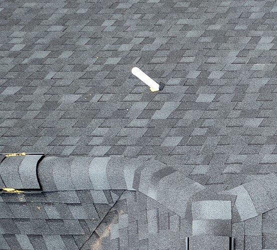

![BERTAMINI 165 HIGHLANDS CHASE.002](https://global.discourse-cdn.com/internachi/original/4X/6/1/8/6183b8f6d028fcc4c01ec2b4fd5e868b1c512d88.jpeg)
I inspected this new roof today as part of a pre drywall inspection. I don’t see the traditional boot or metal flashing around this plumbing vent. I’m sure it’s fine but thought I would get feedback here. Thanks.

Richard,
Image is not very clear. Being new construction, it looks like they just stubbed the PVC vent though and haven’t put the boot on yet. Which at this stage happens sometimes.
It also looks like somone got a little excited with the great stuff at the ridge vent and around the vent pipe.

I shoot in RAW and zoom in on screen. I should have posted a cropped picture to see it better. I’ve posted that below. Thank you.

> [@rbrown56](#):
> Here’s a zoomed in look. My form of inspection is just fine.
No visible waste plumbing vent boot flashing.
Piece of composition shingle leaning against the plumbing waste vent.
Extruded yellow spray foam at the plumbing vent roof covering intersection.
Extruded yellow spray foam at ridge vents. Various locations.
You think the roofing or insulation installer, or even the general contractor, installed spray foam at visible roof deck openings to prohibit daylight from entering the attic space?
A betting man would. 5 will get you 10!

The roofer just hasn’t come back to installe the boot yet. The plumber just cut the hole and installed the vent. Make a note of it and move on.

Looks like the plumber got there after the roofers left and sprayed foam to minimize water leaks. The roofers need to come back to install the weather boot. This is the general contractor’s problem if they have one.

Well the roofer probably installs vents on a regular basis and was not informed by the builder that his hvac/insulation guys are going for a sealed or conditioned attic. Roof also goes on way before insulation is installed in the construction process. Waste of money and communication problem. Who knows

I would recommend that during any pre-completion inspection, that you talk with the builder, not us.
But as usual, they’re just going to tell you the is having gotten around to that yet. You do need to call it out in your report because you can’t inspect what is not yet complete. There’s nothing wrong with it, yet!
Were you not there to inspect drywall?
When you get around to inspecting that, no it is not okay without flashing
That’s a roof.

In my pre-drywall reports I have an opening paragraph which describes the basic stage of construction.
Example:
The shingles have been installed and flashing in some areas. Rear deck porch has temporary supports. Workers were present installing cladding and soffit material. Approximately 50% of the windows and no doors have been installed. There was no driveway or sidewalks. Plumbing, HVAC and electrical were in the rough stage of completion. Workers were present and many systems and components are considered work in progress. The exact stage of completion was not determined for this is not the purpose of this inspection. This is not a code inspection, however at my discretion code may be referenced to help the customer better understand the problem or to help illustrate further due diligence may be needed. I have evaluated what is present at the time of inspection and made recommendations accordingly.
With all that said, do we point out the missing boot or not? Well, if insulation is present then this is a defect in my opinion.

Is that great stuff (expanding foam insulation) I’m seeing at the plumbing vent and ridge vent?

I just did the pre drywall inspection yesterday and drywall hasn’t been installed. Looks like the roofer just needs to come back to install the boots. I just wanted to make sure there wasn’t some new technique on sealing roof penetrations. Who better to ask than my fellow NACHI inspectors? Most are helpful and constructive.

While spray foam insulation can/may be water-resistant, to a certain degree but not entirely,
it’s not a waterproof sealant ‘and shouldn’t be relied upon as a sole water barrier.’
Suspect: Ridge vent poorly installed.
Observation: Yellow expansive spray foam is visible in various locations, on both sides, throughout the entire length or the plastic ridge vent/roof deck intersection.
Hypotheses: Yellow expansive spray foam was used as a sealant barrier to prohibit daylight and inclement weather from entering under, through the raised plastic ridge vent and into the cathedral Ceiling assembly into the conditioned living space.
Side note: While spray foam insulation can/may be seen as temporarily water-resistant, spray foam is not a waterproof sealant and should not be relied upon/depended on/counted on/ to, nor placed reliance as a sole water barrier. Expansive Spray foam is affected by moisture and UV exposure, with open-cell foam being particularly susceptible.
Summary: Yellow spray foam, it’s normally/typically/likely open cell, but the foam color alone isn’t a definitive indicator.
Closed cell expansive spray foam can come in yellow and is more resistant to weather and UV rays.
