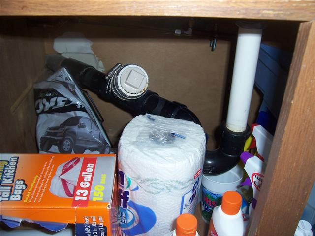

Sink drain gurgled when tested. What do you suppose the cap is for & do you think it is vented properly?
House on Saturday had the diswasher discharge into the basement shower.

first pic may be misleading, but it appears the horizontal run after the trap is negatively pitched.
if so, that’s likely where the gurgling comes from.
i would think the cap would make for an easier snaking.
to comment on venting, i would have to no where this drain leads to.

First pic is a cleanout. Gurgling is usually a venting problem. The dishwasher hookup would be wrong because the compression fittings are not readily accesable. Were they are would not be considered accesable.
