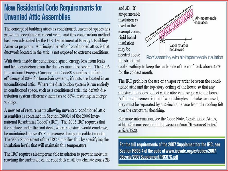

So, now days there is a lot of discussion on whether or not to ventilate an attic.
What are the thoughts out there in Inspector land?

Good info, but I would not be eager to use or endorse foam applied directly onto the underside of the roof sheathing. If you have a leak you are in big trouble.

I certainly agree with Raymond. I’ve never seen an attic that will not leak at some time. So when it does, what happens.

I can’t speak about all the new foam attics. No one really can they are all too new, at least around here. I did one of the first ones I’m aware of in this area for the Plano Housing Authority about 4 years ago.
So when it does, what happens? Same as any other leak except leak may go undetected longer. Building materials rot and WDI/WDO appear. Homeowner or insurer are out whatever it costs to repair.

Go to: www.buildingscience.com and search for attics + venting. The attic you’re talking about is the best candidate for the “conditioned attic” treatment. Its been used quite a bit in the BUILD AMERICA program, Search there also.
Go to: www.buildingscience.com and search for attics + venting. The attic you’re talking about is the best candidate for the “conditioned attic” treatment. Its been used quite a bit in the BUILDING AMERICA program, search there also:
http://www.eere.energy.gov/buildings/building_america/affordable_housing.html
Attics which have been converted to bedrooms are perfect examples of non-ventilated attics. You can use spray foam or fiberglassto insulate them, but the net effect is the same.
A conditioned-air space doesn’t care how it looks, it reacts according to the laws of physics.
The US Dept of Energy newsletter this month contains an interesting article on this topic.
