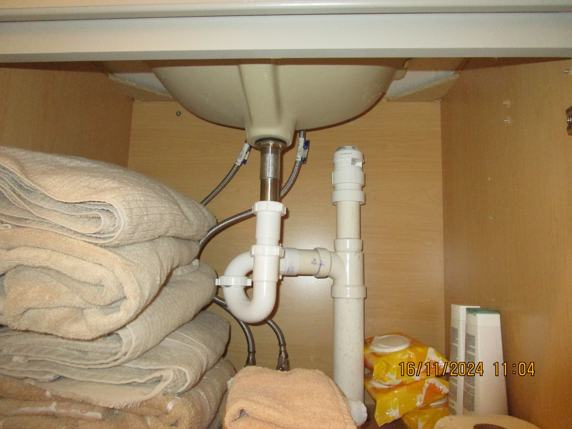

2nd floor bathroom, when the shower/bath water us turned on, the water in the toilet begins to dance as if it was a very windy day. Shut the water off in the bath and the water in the toilet stops moving. There was no vent pipe located in the attic space in the area of the bathroom. I’m thinking the lack of proper venting is the cause, but thought I’d throw it out there to see what other may think.
Does the toilet flush normally?
Flushes just fine, and no sounds or back ups in the tub drain.
Does the toilet dance when the vanity is turned on?
Negative, the vanity had 2 sinks, each with their own AAV

@kleonard There was no vent piping visible near that bathroom in the attic or terminating out of the siding. Nothing, notta, ziltch… The vanity sinks had their own AAVs installed. That’s it…

Probably vent related. But did the home have at least one main stack vent?
As long as there is at least one 3" vent, then the AAV’s are fine. (at least in my area)
Negative. The master bath and laundry (both 2nd floor) had their own individual vents on the other side of the home. Kitchen island sink on main level had an AAV.
The only other vent in the house was near the furnace in the basement, another AAV sticking out of the concrete floor.
Those AAV’s in the bath are not a substitute for a 3" stack vent for the toilet and tub. Without proper venting the water in the toilet will move due to the pressure of the pipe caused by the tub draining.

Marcel is surmising that the two AAV’s are the only venting for the whole bathroom. That is my conclusion as well. Those AAV’s are limited in air volume to begin with (e.g. barely adequate for a single sink) and even less so if they become dirty or clogged. There is a reason they are called “cheater vents.”
