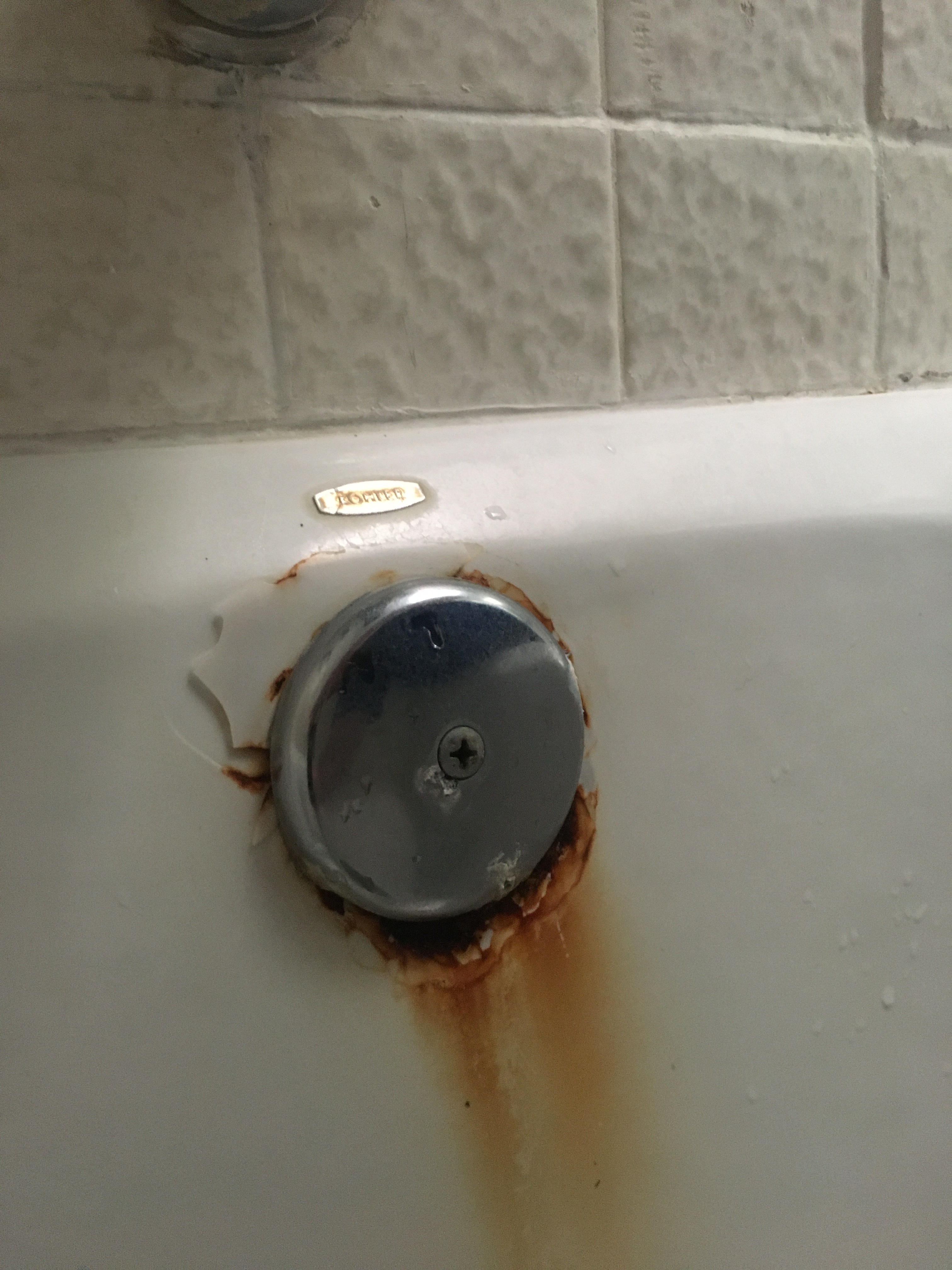

I do not know if this is the correct place to add this but I am creating this for everyone to add photos of issues from inspections as means for visual inspection. I am doing this because I do not have enough homes to inspect but still could use the experience.
Please add pics!
What is up with this?
Garrett, could you comment on the issues that you see with each picture, please?
It will help everyone… :smile:
And while you’re at Larry’s suggestion, what’s up, if anything, with this :cowboy_hat_face:
Gladly! I put them up there without stating issues to promote interaction etc.
Image #1: detached handle and leak at gasket.
