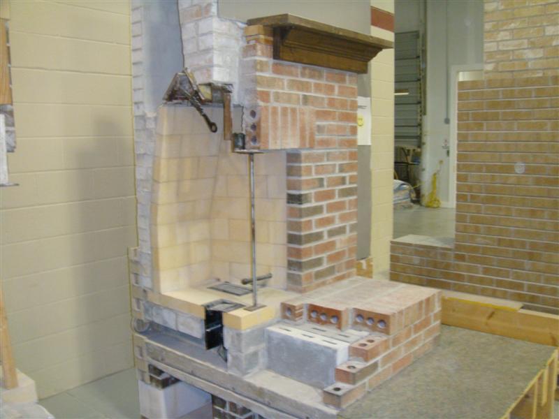

Here is a right and wrong way to build a fire place.
Can any of you tell me which picture is wrong and why?
Man, would I love to send a www.NACHI.TV crew up there.
First one. CMU wrong way.

Hint …
Check all the components
Masonry,angle iron,hearth,mantle,etc.
We also discussed CMU and silicon treatments ,Limestone verses concrete etc…

I just looked again and the big :frowning: give it away. :wink:
